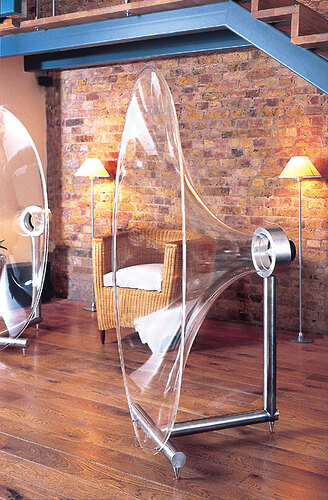

On paper (I haven’t heard yet) I rather like the Fergusson-Hill FH1 acrylic transparent horns, which although big are near invisible - they only go down to something like 150Hz, and therefore need a special sub (special because going up a lot higher than normally required of a sub).
