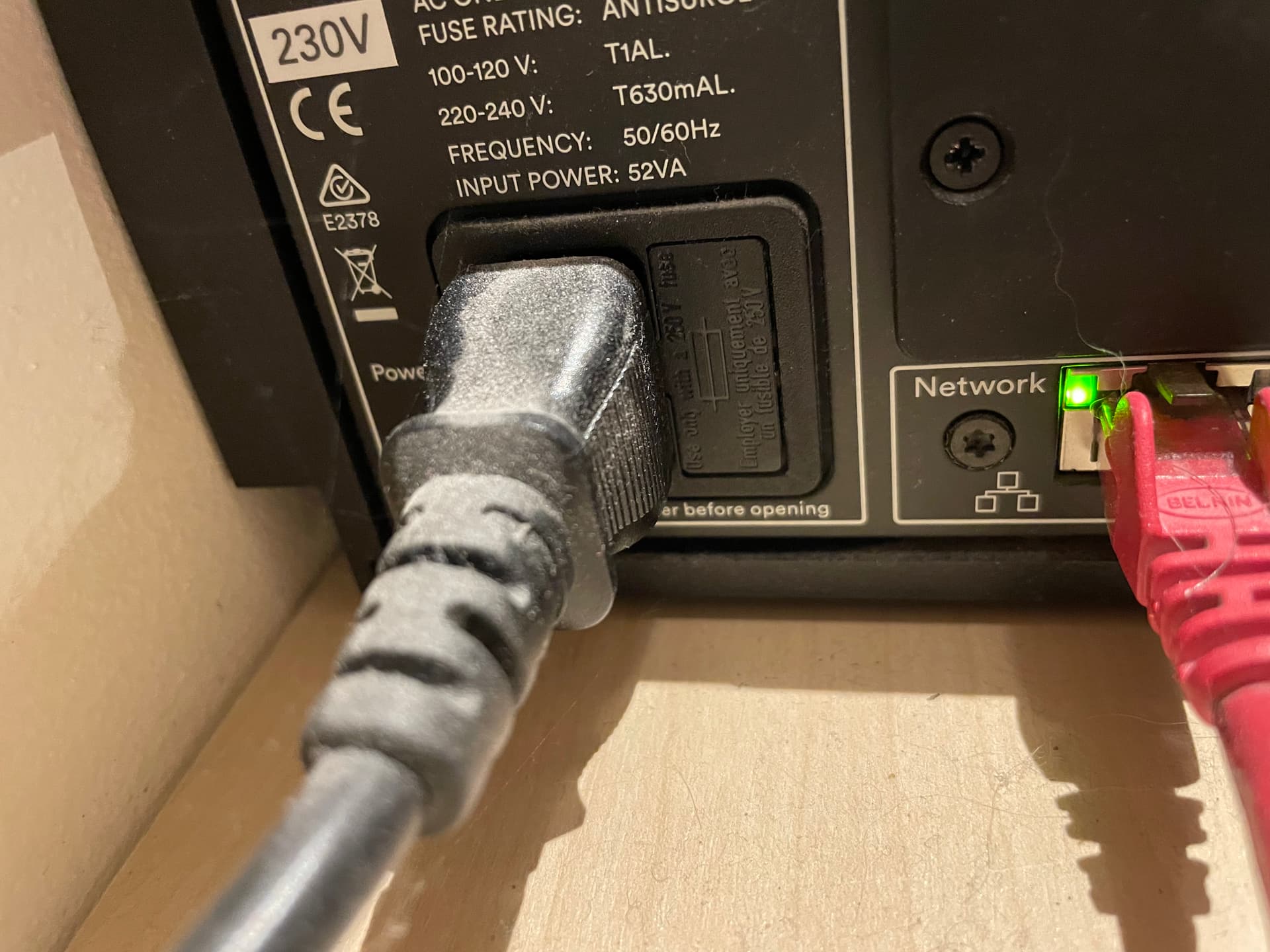

The fuse is located right next to the power cord. Mine is a 240V unit but I think yours will be similar, but with a different fuse. Besides the working one, there is a spare in there. It’s very important to use the correct fuse, which is a slow blow type for a start.
So you unplug the Core, prize out the fuse holder, swap the two fuses over and press the holder back in again. Then power the unit up. Here is where it is located.
