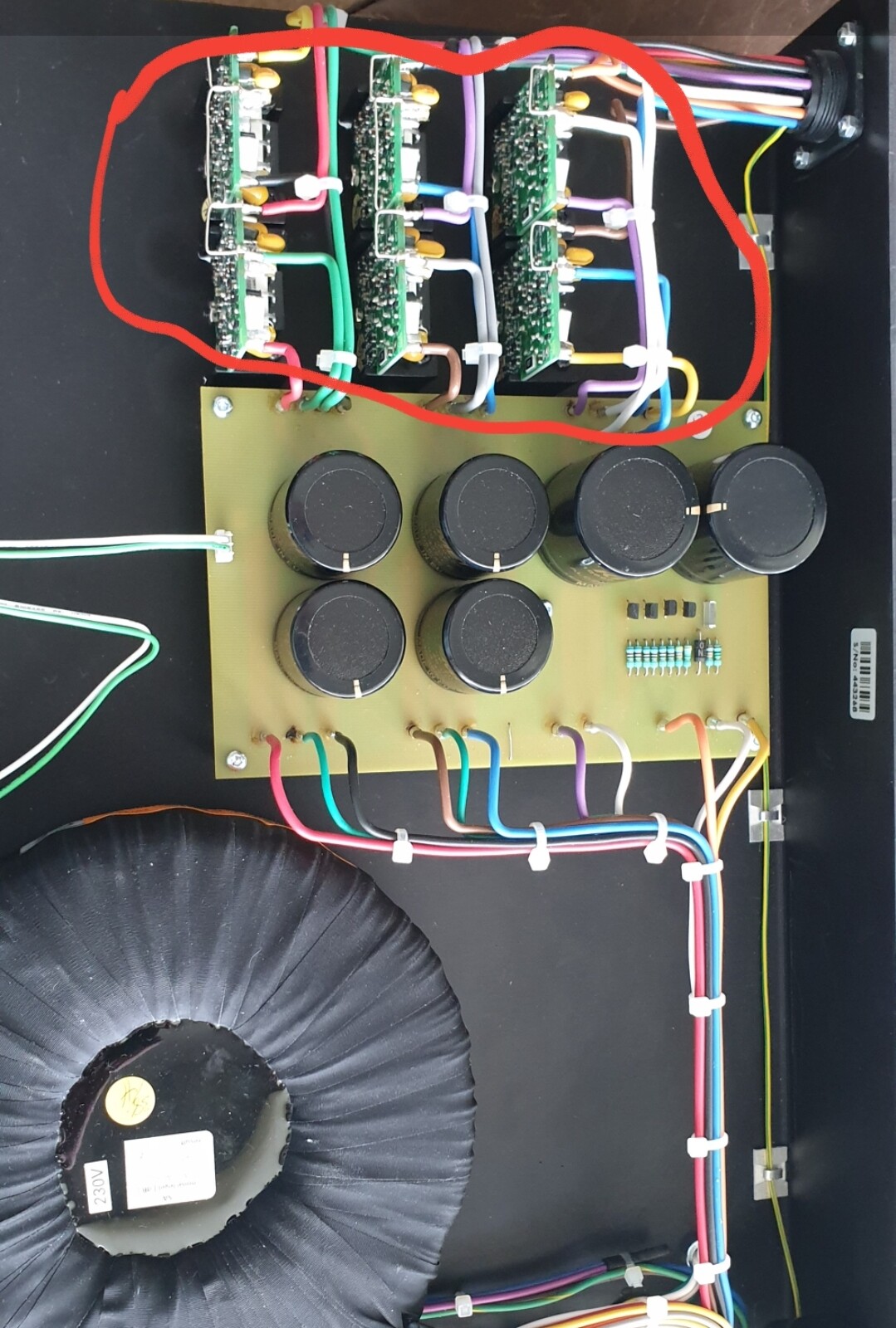

Naim were able to confirm that all was well from a photo of the inside of the unit, this is the picture I sent them

These are the DR regulators in a xps dr.
Check with Naim, but I can’t imagine these are available other than from Naim though.
Those look exactly like the ones in my XPS, so I’m pretty sure by now I did indeed buy a DR version.

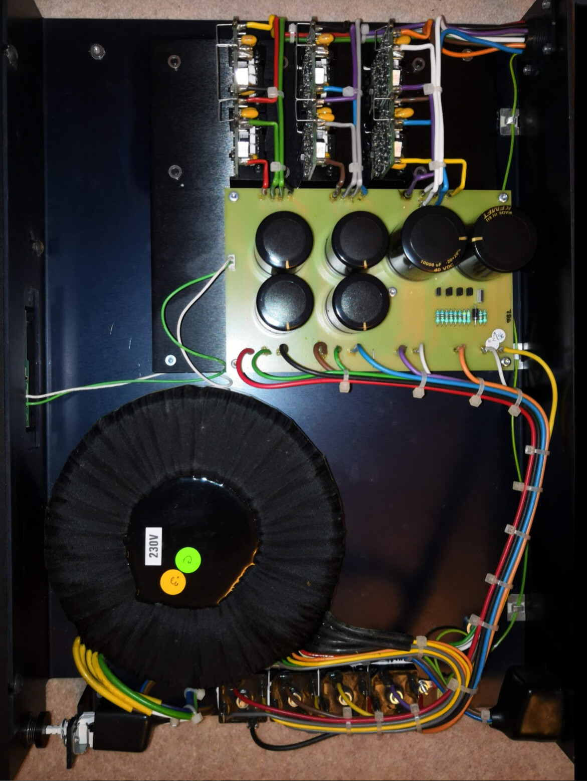

I did as most of you suggested and sent some pictures of the inside of the XPS to Naim support. On that basis they could confirm that my unit was upgraded to DR. Thanks again.
