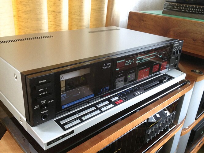

You’ll need to switch between Tape and Source on the deck itself. Most 3 head decks will have off tape monitoring and a button too switch between the two. Be careful though as Nakamichi used to offer 3 head decks with no off tape monitoring (481, 581, and 660, 670 and 681). Also, IIRC, some Aiwas had automatic monitor switching, but could be manually over-ridden. If you’re a fan of meters then the Aiwa AD-F770 had some of the best.

The AD-F770 had off-tape monitoring with a source/tape switch (first of the three buttons on the far right). It’s an excellent deck and can sound really nice.
