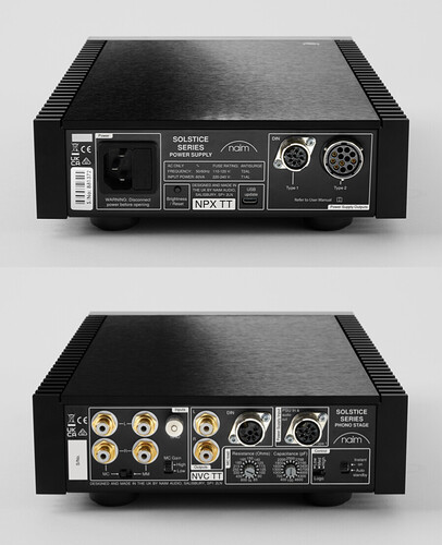

For the new Solstice Phono Stage NVC TT Naim seem to have gone with a more common/flexible 100pF, despite them also being in charge of the cart (i.e. they could have designed one suitable for 470pF) :thinking:
Have they?
All I can see is fly-by-wire switchable load and capacitance for MC. I will need to dig further to find the spec (and capacitance) for MM.
Stereonet has the specs in its article.
And perhaps also of interest:
Ah, the cart is MC of course. So this last bit is not relevant to the MM input capacitance.
