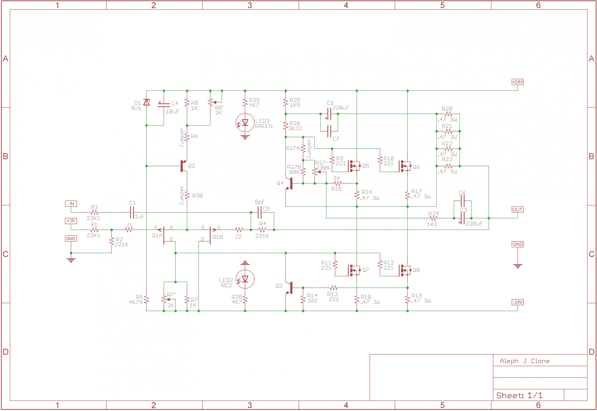

Planning to build the Aleph J from Nelson Pass (Pass Labs / FirstWatt).
Main question is does the UQ2 be able to make a difference between external amplifiers.
Incidentally that’s not single ended topology, it’s a pseudo-balanced input dynamic bias push pull design.
Certain components in that design will be massively critical to the overall quality, selection of these components will be, well, interesting.

The UQ2 can certainly be good enough to allow differences between some power amps to be heard, however, the interaction between a power amp, the speakers and the room is still more significant, and you’ll usually hear more difference here.
Having said that some characteristics (such as ‘inner detail’ and some transient characteristics) may not be present from a UQ2 at a sufficiently defined level to be able to distinguish differences in these specific traits in high end power amplifiers.
Note that this also assumes that you have speakers that are also exceptionally revealing.
On the subject of speakers I’d be concerned about that amplifier driving ‘difficult’ speaker loads - i.e. speakers with wildly varying impedance characteristics vs frequency.
