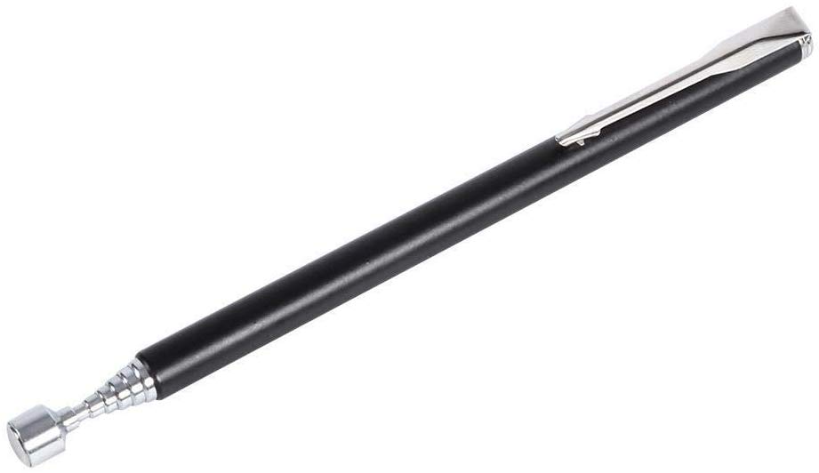

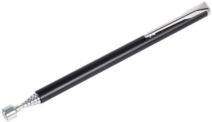

If you can get a small magnet pick up tool you might be able to fish it out if it hasnāt lodged somewhere. I had this problem years ago and was able to tilt slightly the unit to have the puck slide toward the front where it can be fished out.
