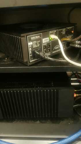

Hi , I am asking for help how to connect the preamplifier to Unity Atom ? I have QUAD Artera Stereo for testing but it doesn’t work
You connect the Aux out RCAs on the Quad to the RCA input on the Atom. It’s a rather odd thing to do, but doubtless you have your reasons.
The pre-amp connection on the Atom is pre-amp out; I.e. if you want to connect a subwoofer or a power amp.
Any analogue input goes the input socket.
Okay, thanks, it works

Don’t you mean power amplifier? Adding a preamp to an atom is still 100% atom driving the speakers. All you have gained is more inputs.
Like this: Other preamp > atom line input > atom preamp > atom power amp > speakers.
I suspect what you really mean is:
Atom preamp output > other power amp > speakers.
Quad Artera Stereo - Amplifier
Uniti Atom - preamplifier, DAC and streamer
You asked how to connect a preamp, but you have connected a power amp. Perhaps your thread title is misleading people?
Yes exactly.
Anyway I think your question is solved.
Exactly, I wrote it wrong but the problem is solved and the effect is fascinating
