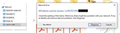

When I open Explorer and click on Network it shows me the UNITICORExxxxxx (x=number of Uniti Core) - it means it can see the Core, but I can’t connect to it when I click on it! I just want to be able to transfer files from there to my PC. Any ideas how I can fix this?

I’ve tried it and get the message in the picture attached. Strangely in the network section it shows the Core.
Yes, I entered the address correctly.

Very odd. Have you got SMB enabled in your PC? You don’t need SMB1 which is where the security issues live but you do need SMB2 or SMB3.
Yes, it is enabled. :+1:t2:

Well thats not an ip address you should be entering two back slashes then an actual ip address i.e. 192.168.0.xxx
As Gary says. You can get the right IP address from About in settings in the Core home page in the Naim app.

To make sure you understand- that’s what I’ve entered:
\192.168.1.23
Ok? No success……
\\192.168.1.23\downloads
And this is windows explorer not a browser, right?
Does that work?
Yes, and it does not work :disappointed:
