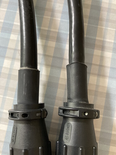

The S-XPS Burndy cable is the latest and best Burndy for connecting an XPS/XPS2/XPSDR/XP5XS to various units. This Burndy cable superceded the earlier grey then black XPS Burndy cables, and can be identified by having S-XPS typed on the collar directional indicator.
The above pictures show the S-XPS Burndy on the left and the earlier XPS Burndy on the right.
Apart from the directional indicator band (NA-XPS on the earlier Burndy cable) they are otherwise very difficult to tell apart, however, as you can see the later improved S-XPS Burndy uses a slightly thicker cable than the earlier XPS Burndy.

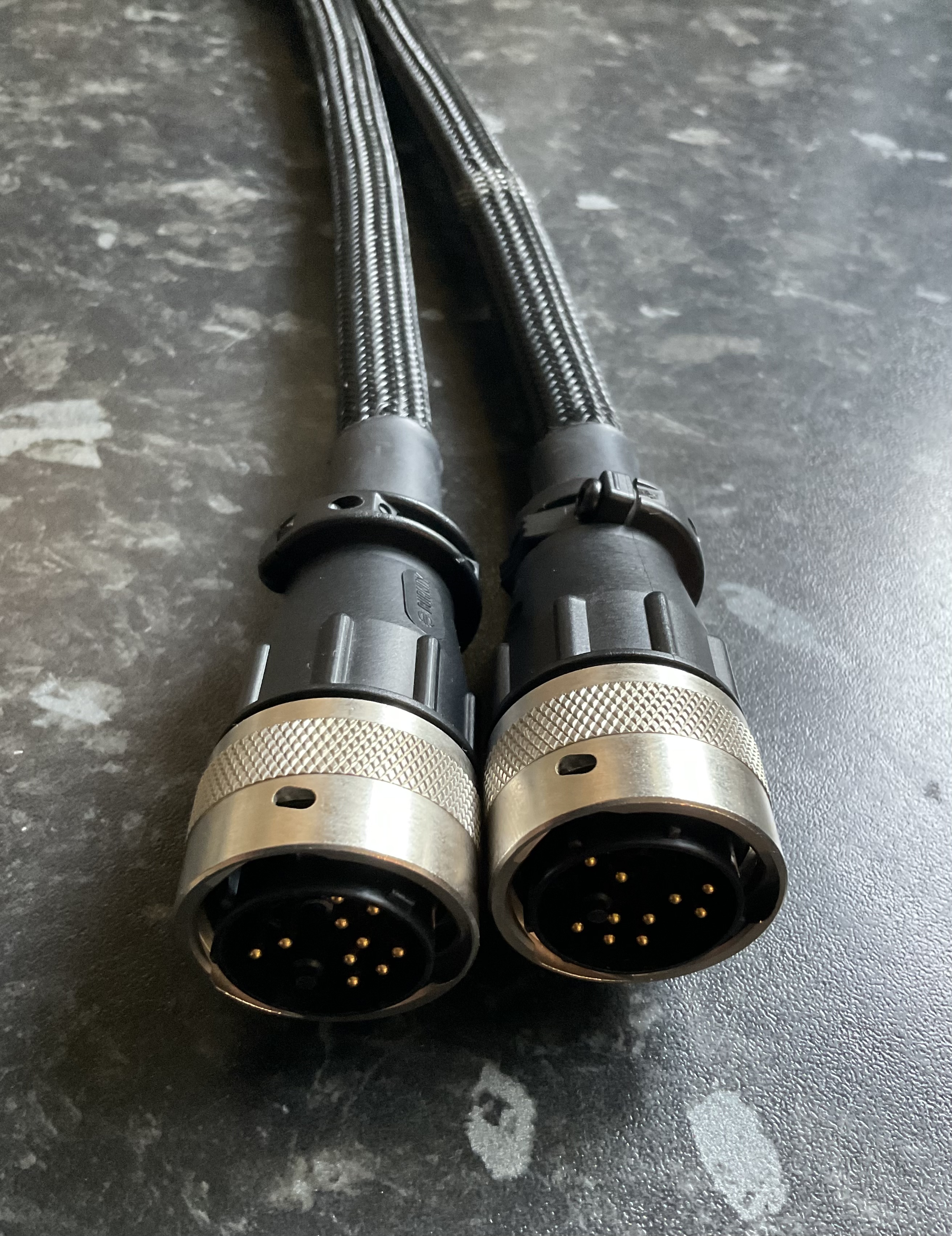

NDS - 555PS Burndy (cable 1) - 10 pins;
NDS - 555PS Burndy (cable2) - 7 pins;
Note that, apart from the number of pins, cable 2 can easily be identified from cable 1 by having two white directional indicator bands just visible under the braided outer sheath.

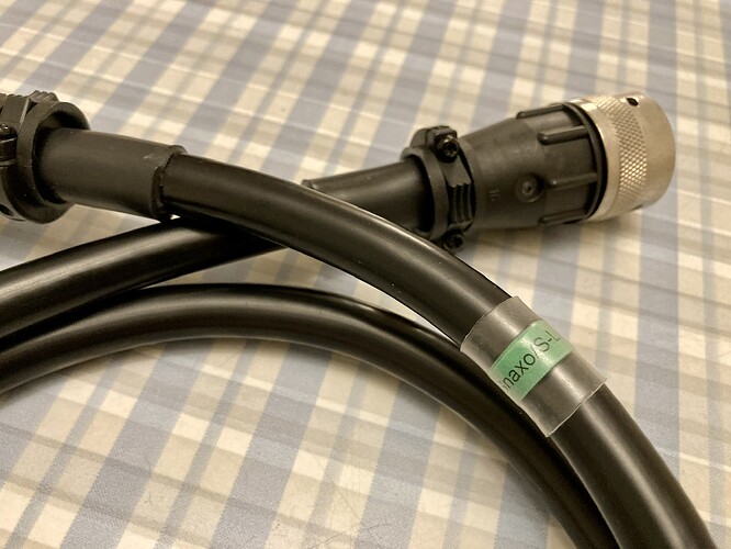

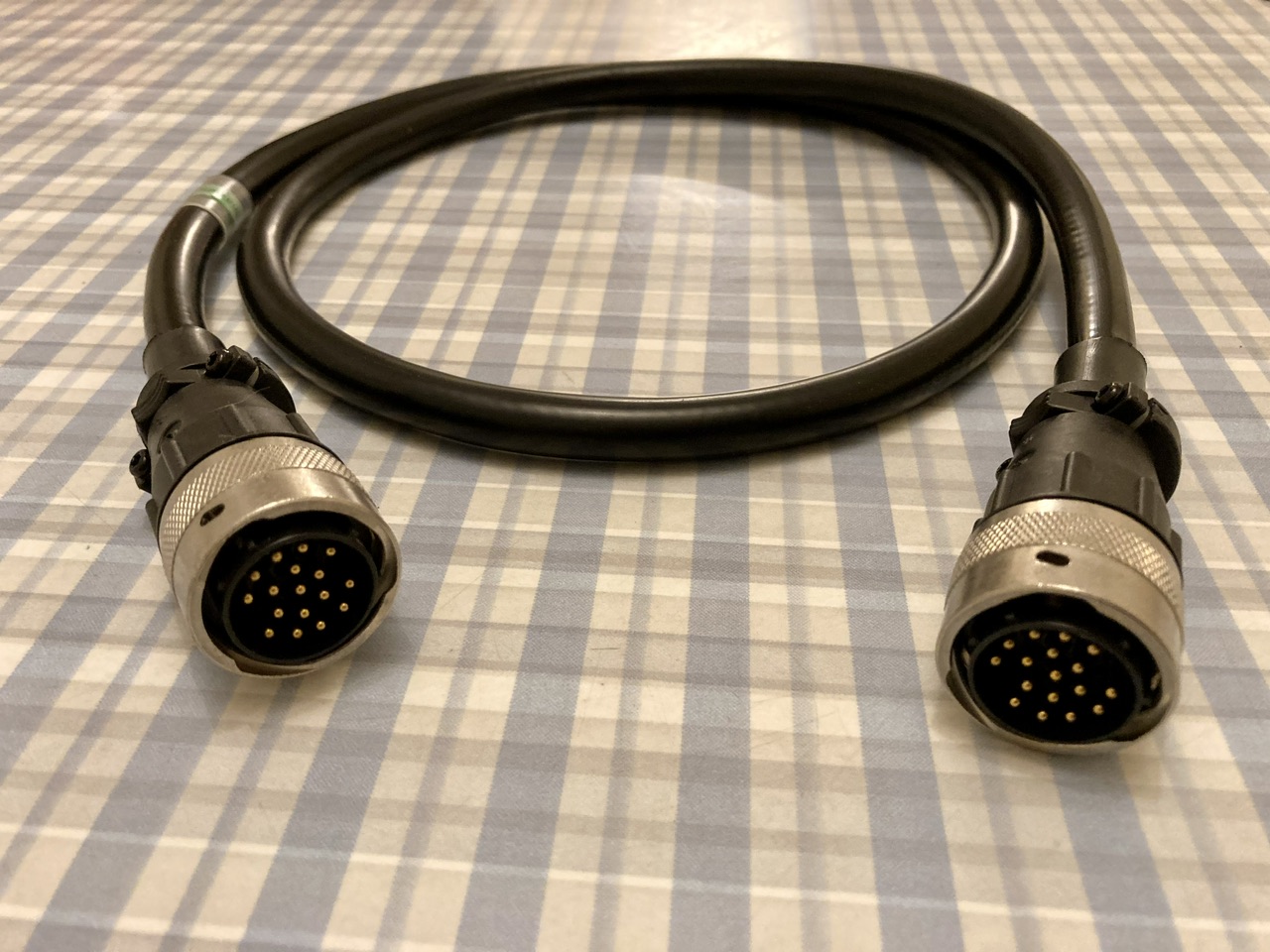

SNAXO/S-NAXO Burndy - 17 pins;
The S-NAXO Burndy is the latest and best Burndy for connecting a SNAXO or a Superline to a Supercap. This Burndy cable superceded the earlier grey and then black cables and can be identified by having S-NAXO or Snaxo/S-Line typed on the collar directional indicator.
