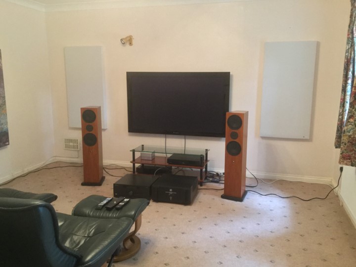

In my own circumstance I had a room with very poor dimensions for music playback (refer to my AMROC post no 53 above). I had tried to solve some problems with basic thin panels. It needed decorating and looked like this (apologies for trial equipment in foreground- that was temporary)….

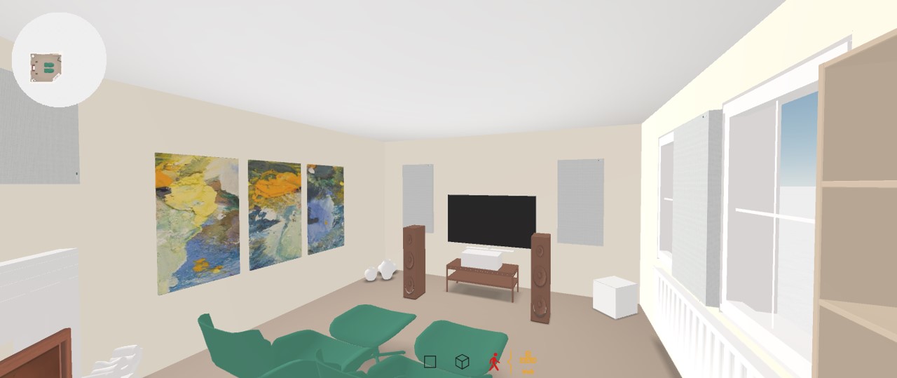

Then I started to contact various companies who could do room design for music playback. I and others have given examples elsewhere on this thread. Some wanted to charge a lot of money for consultation. Others not. Some provided a design tool accessible through the web. I used one such example. Here is the starting point of the above room, entered in the design tool……..

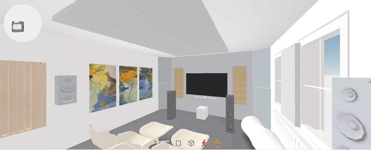

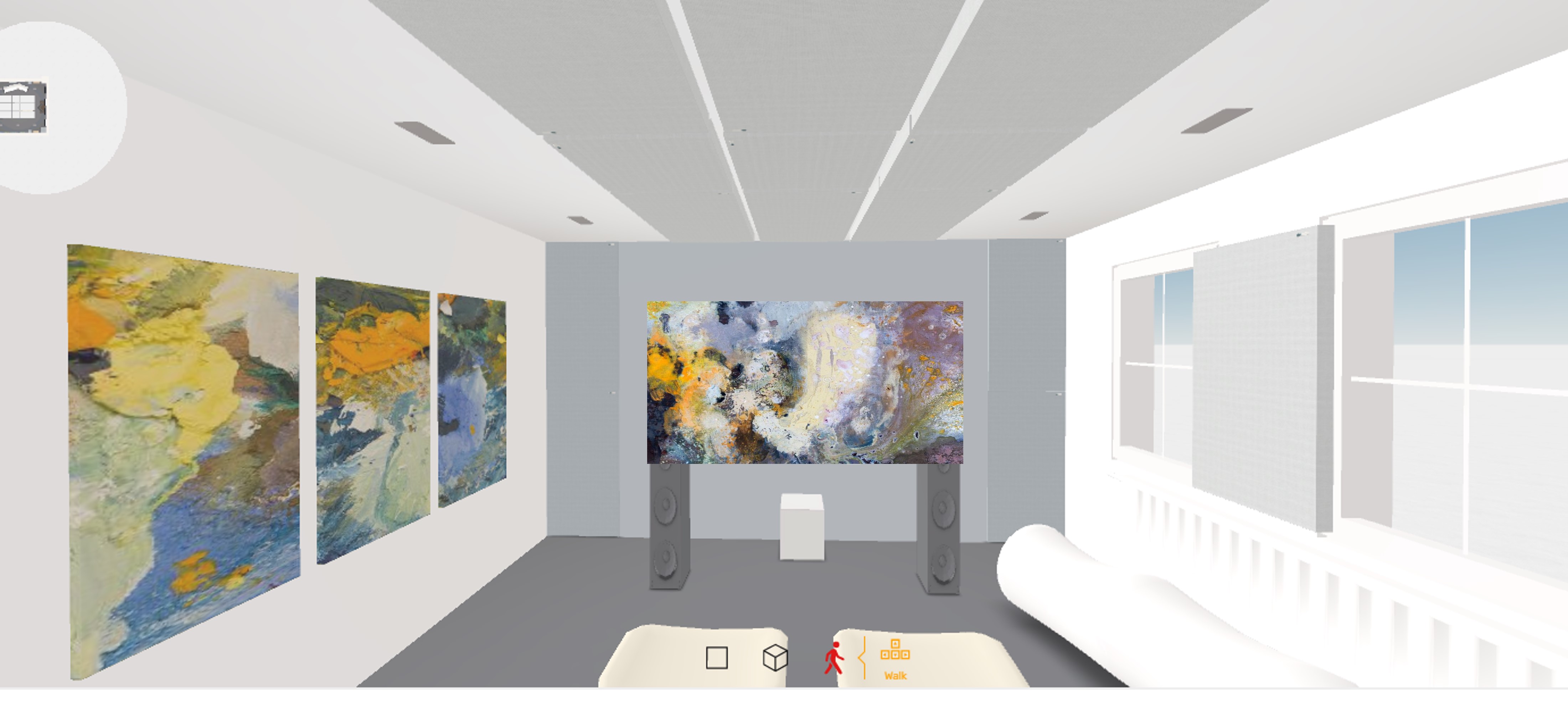

Here is a sequence where I am comparing Tri Traps in the corners with some Diffusion and contrasting with Soffitt Traps and 15cm Monster Base Traps……

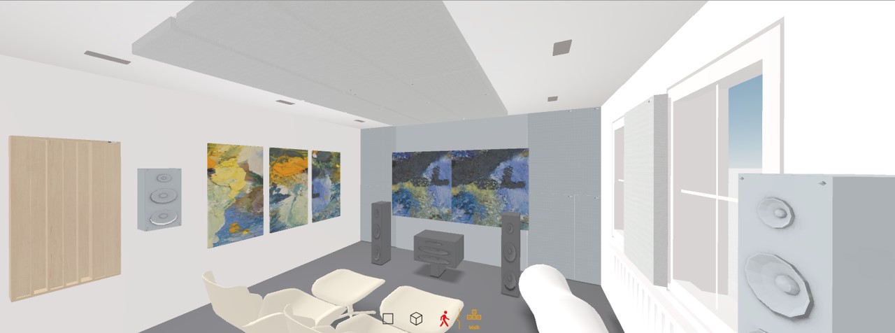

Here is a sequence where I explored adding some 15cm Monster Bass traps on the front wall either side of the TV, and cover the TV with sliding moving art panels for the transition between movie watching and music only modes of the room…….

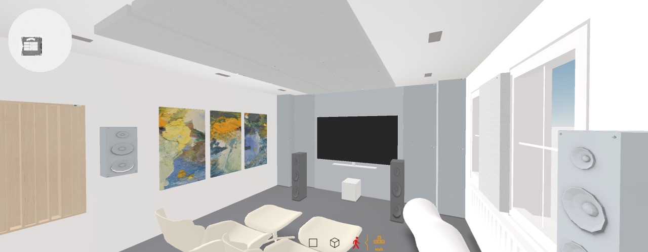

The above sliding panel solution to cover the TV was what I decided to proceed with. Here is the front view in the simulation.

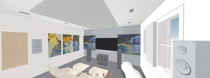

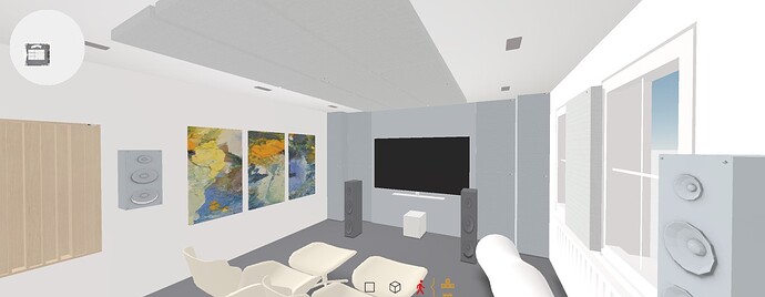

I had to amend the concept….. went into the visualisation design tool again (2 or 3 years later) and amended the concept this time to have Soffit traps rather than 15cm thick Monster Traps in the corners (more visible, but better acoustics), and a moving/ retractable TV mount, again better acoustic, covers with art panels that need to be manually removed.
This is it in progress in the 3D view of the design tool……
