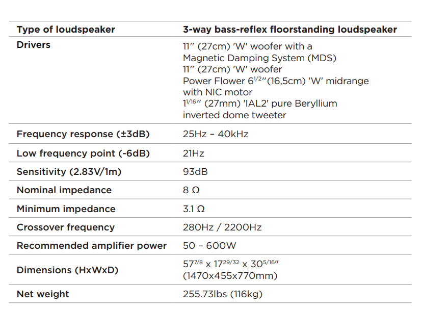

Focal Maestro Utopia specs :
Now if you look at the impedance curve of the Focal Maestro Utopia you’d think: ok, I’ll go for the Statement.
Unfortunately, speakers manufacturers don’t communicate much on this subject. It’s tricky. The impedance curve is a bit of a taboo subject.

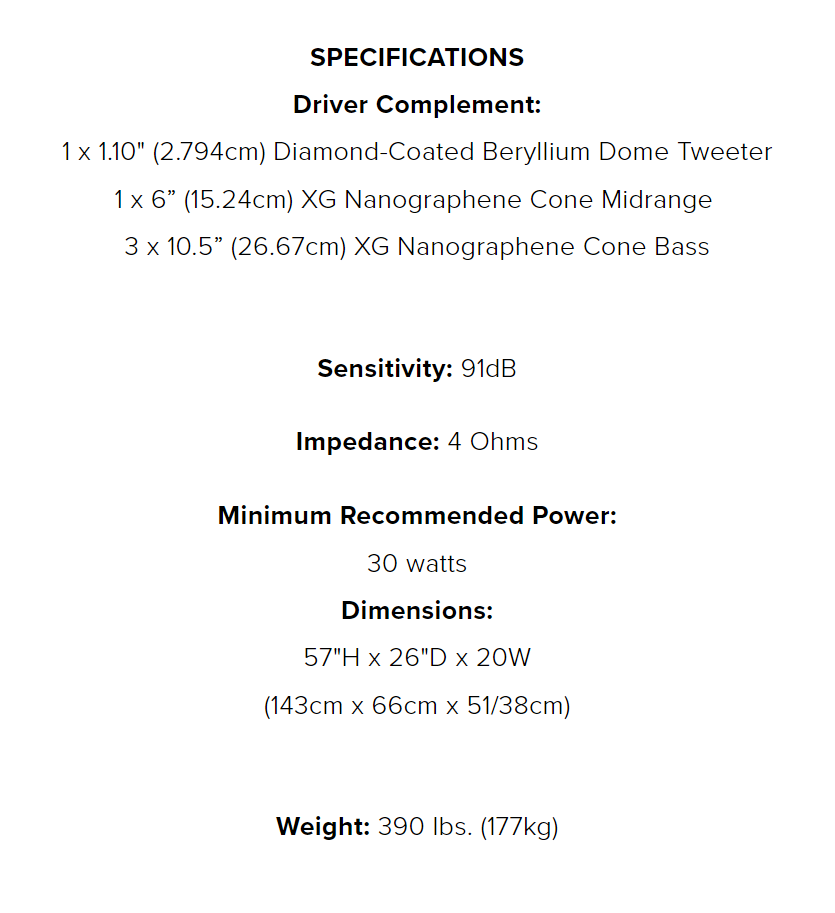

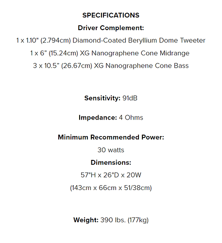

Magico M6 specs :
Looking at the specs of the big Magico M6s, you think, wow, I can drive that very easily with a Naim SuperNait 3.
Well, no, the truth is that you need a Naim Statement or Soulution 711 or 701, or equivalent.
