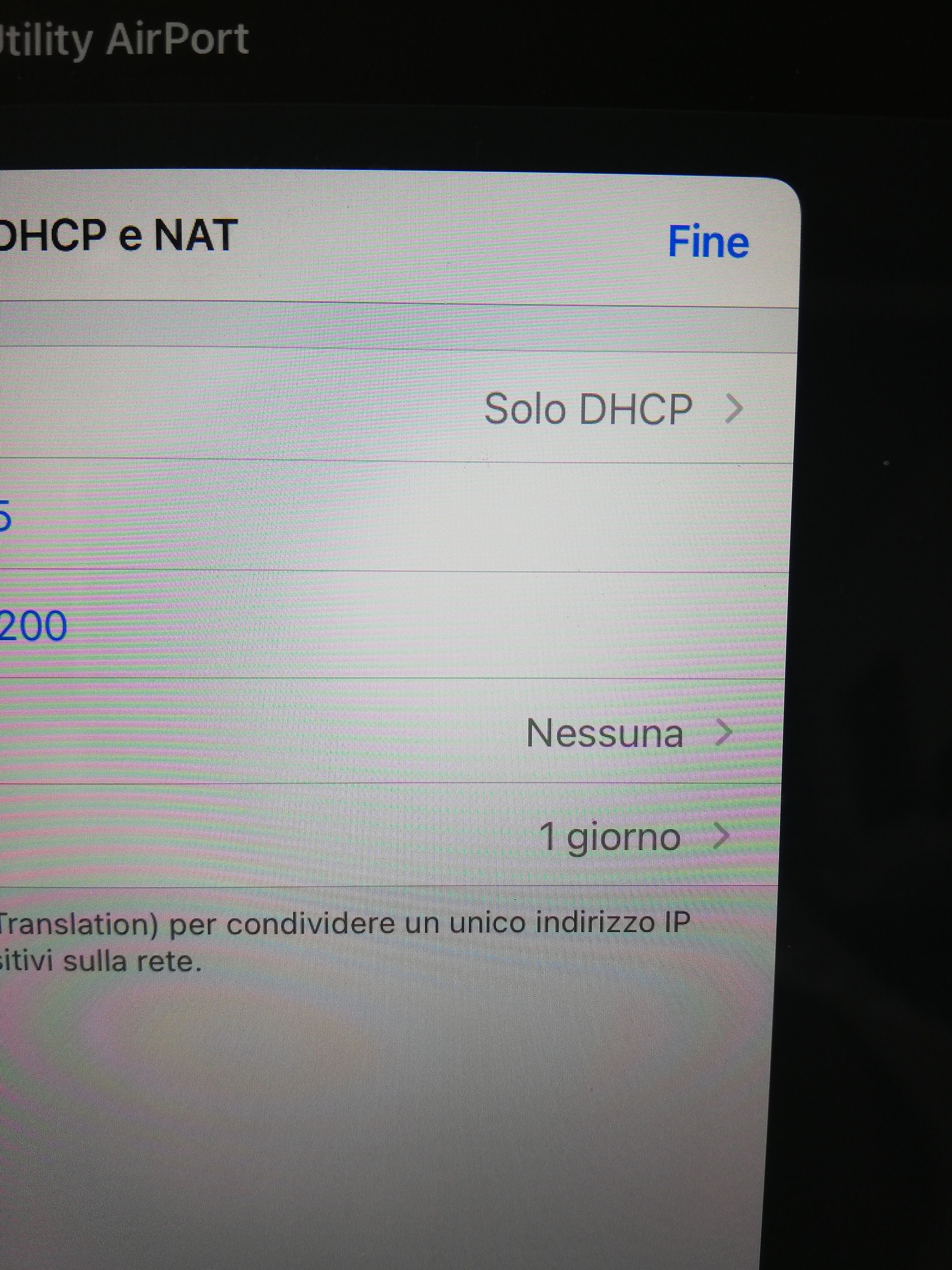

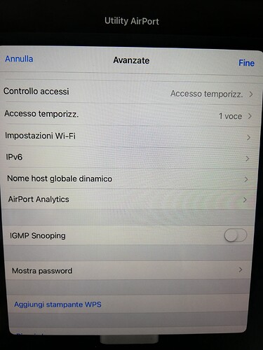

Thanks Simon, I appreciate your interest and your preparation. In fact I reset the Extreme since I don’t know what happened alone to have two nats. Now I have created the Extreme only with hdcp, I am attaching photos of how it is today and it seems to be fine. Yesterday, however, with hdcp and nat I did not see from the iPhone and iPad any network hard disk for the ND5 xs2 on the Naim app. However, often if I listen to internet radio the jazz groove west after a few 15-20 minutes of listening the connection drops. Only on this radio, the others do not, they distribute music without interruption. I would like someone to try and write an email on the radio to inform about the problem.

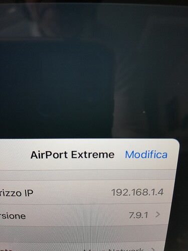

My rel is 7.9.1
I can’t understand the menus you show unfortunately… but let your wifi simply act as a bridge, and have just one dhcp server, typically on your broadband router.

Ok. However the airport is connected on the Wan port to a Telecom modem port. A new network has been created on airport with its own name. No other cables are connected to the airport extreme. On the Telecom modem the wifi is off. Airport is on DHCP. On airport IGP snooping is off as ipv6 is off. In my house the cable network is managed by Telecom and swicht modems while the wifi is created only by apple airport extreme. Upstairs I have an airport express that boosts and extends Extreme’s wifi.

Yes that should work, your ISP device is acting as a modem only, not a router in the setup you describe… I would enable ipv6… these days many services use it if available and can work more effectively than ipv4 as well being more plug and play (you probably are not even aware of what is using ipv6) … though Naim only support ipv4 currently.
I assume you have IGMP snooping disabled because services start to have problems with it on? I found this on early Apple Airport products… if you can turn on.
