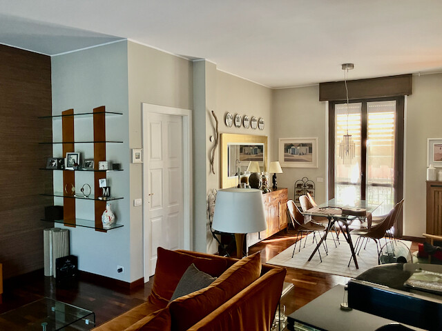

In this space
sofa, glass tables and lamps will eventually go. I’ll be left with a 3.85 x 3.60 space to be used for music listening. The sideboard hasn’t to stay or stay there perforce. The Scandinavian shelf will go along with its twin, now in the cellar.
The space opposite the French windows opens onto an 11 sq. mt. dining alcove:
So the room is asymmetric as far as reflecting surfaces are concerned.

I also looked at your room and thought it has a lot of hard surfaces. Curtains, rugs etc needed?
Yes 100% agree, everything is very reflective, plus speaker positioning is close to side walls.
Reflections cause time domain problems that affect the sound quality as heard in the room.
The room begs for acoustic treatment, rugs & curtains as suggested, also consider acoustic panels in the wall corners to absorb sound waves.

the room is actually not too reflecting, not in any detectable way. The speakers, when positioned on the ‘brown’ wall, fire across 6.5 mt. and find a large sofa, a baby grand and a full bookshelf on the opposite wall.
The French windows’ glasses are screened by thin tents and a thick rug was laid (then removed) on the floor between the coffee table and the speakers. The sound is surely never too bright.
While I acknowledge the relevant effects of room treatment I am not very in favor of it because I think that a living room is not a listening room. A stereo should be chosen to blend with the rest without asking for bespoke adjustments that would alter the visual balance of the room.
I know that my living room is not the product of a designer, but it’s cozy enough and I am not very interested in panels or tube traps.
Thanks for the appreciation of this space… I really love it and have accepted a lot of compromises with the placement of the stereo for the sake of shared life…
Now I am here alone but I want to preserve this loveliness. I’ll check the speakers you mention.

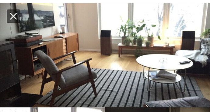

Obviously a rug would help in your room.

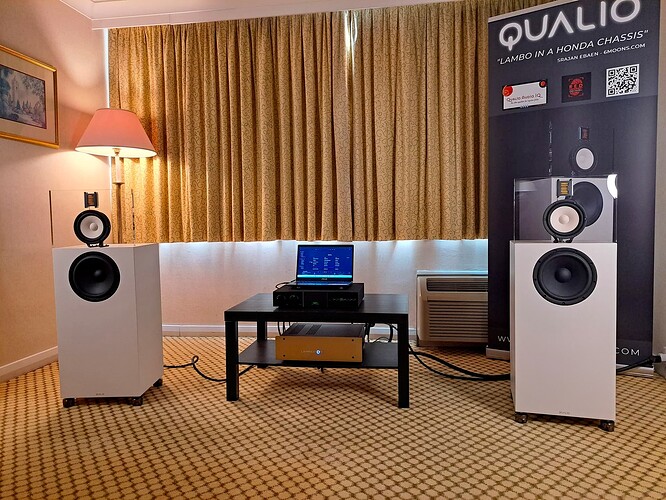

Not sure what kind of sound signature you’re after or what kind of music you listen to but these Qualio speakers from Poland sounded really good on the end of a Supernait.

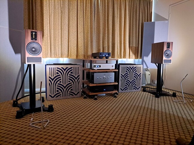

These Kerr Acoustics stand mount speakers sounded good at the Bristol show.
