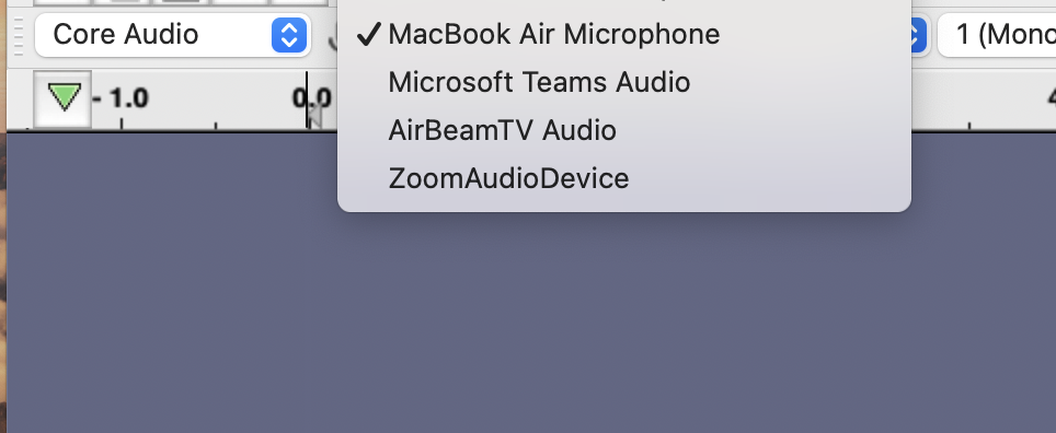

What exactly is the 3.5mm to USB-C unit you mention? I suspect this may be the issue? You can check in your Sound settings - look for the device in the Input tab.

That may do the job, but it may also be what you have already. Have you tried using it, then see if you can select it in Audacity?
