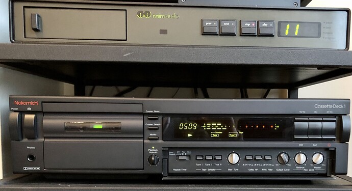

A close friend also on a similar journey has acquired a Nakamichi Cassette Deck 1 recently and has been enjoying that tremendously.

Hence my reference to my friends recent Deck 1 addition which does have manual playback azimuth which gives some accommodation for playback adjustment. The recordings would have been made on a variety of decks ranging from average to decent and almost always “of the moment” as opposed to being extensively planned for or optimised, apart from perhaps me choosing a decent tape to record on to at least!

OK, so if you want easy adjustable playback azimuth (i.e. via front panel control) then your choice is rather limited and they will be costly; you have the Nakamichi CR-7, DR-1, and Cassette Deck One. Of those, the sweet spot his probably the Cassette Deck One. I had the Cassette Deck 1.5, which was similar but did without the azimuth control, and it was a great sounding deck, albeit one where the bass end was shelved up a bit and it tended to sound a bit “fruity” but nearly always a in a very nice way indeed! I never got on with the DR-1 finding it a bit “hard” and unengaging by comparison. The CR-7 is glorious, but as good one is very, very costly these days.

Cassette Deck One would definitely be my first choice here. The NAD is a rare one and they all seem to have suffered over the years, so finding a nice “low mileage” example may be hard. There must have been thousands of the Yamaha made and sold in the UK so that should be by far the easiest, and the cheapest to source.
