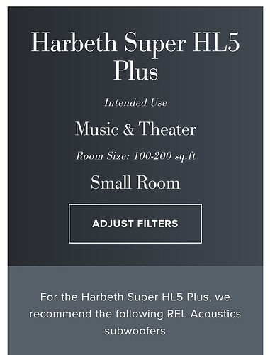

T series are not recommended for the Harbeth SHL5. On REL’s subwoofer pairing guide, the S812 is the minimum requirement. You can still try the S510 but I wouldn’t drop to the T series if I were you.

Was wondering if adding REL subwoofer would stave off the desire for a speaker upgrade. However the REL site recommends a pair of S/510 which would take us (with trade in) almost to a pair of Kudos 606!
