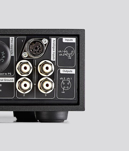

I’ll MacGyver a pair of DIN to XLR cables for now and as soon as possible order the Naim leads from the right island.
The pin connections for the DIN are shown in the little diagram on the back of your 272.
The pin connections on the XLR will be the standard balanced connection arrangement now used on New Classics, which is not the same as that used by Naim on the Classic and earlier 250. Naim no longer bother with the pin diagrams.
You need to ensure that the cables are correctly made for unbalanced din to balanced XLR, and to ensure that one is wired for left and one for right. Quite how that’s done is not something I know, but an expert surely will.

I was wondering whether I’m better off getting 2x XLR female to RCA male adapters to use with the complementary XLR cables the NC250 comes with. Once I get the 332, I just lose the adapters.
That had crossed my mind too. It’s it much cheaper. And with RCA, there are no issues making sure you get the channels wired correctly. I think that’s what I’d do. This one is female to female, so you could just connect any old RCA phono cable.
I’m not sure I’d want to take chances here, especially given Naim’s history of unconventional wiring arrangements.
In balanced XLR cables the ground and negative may be joined, and this could be at either the XLR or the RCA end. I’m no expert, and to be confident of getting it right I’d want someone who knows their stuff, and knows what Naim have done, to make up the right cable.
