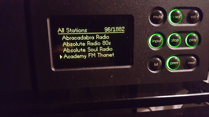

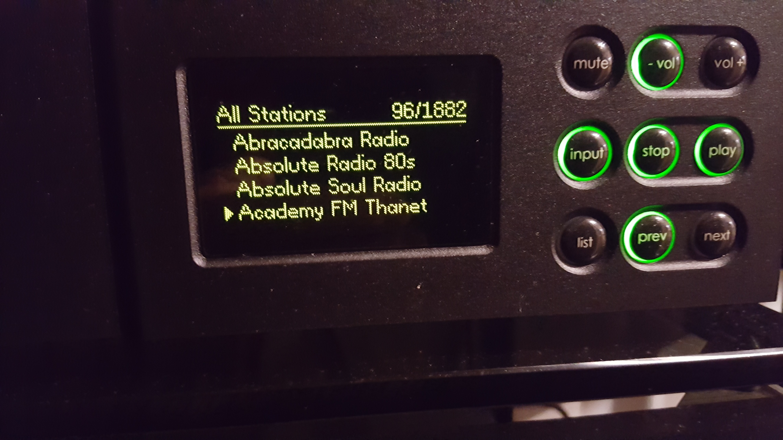

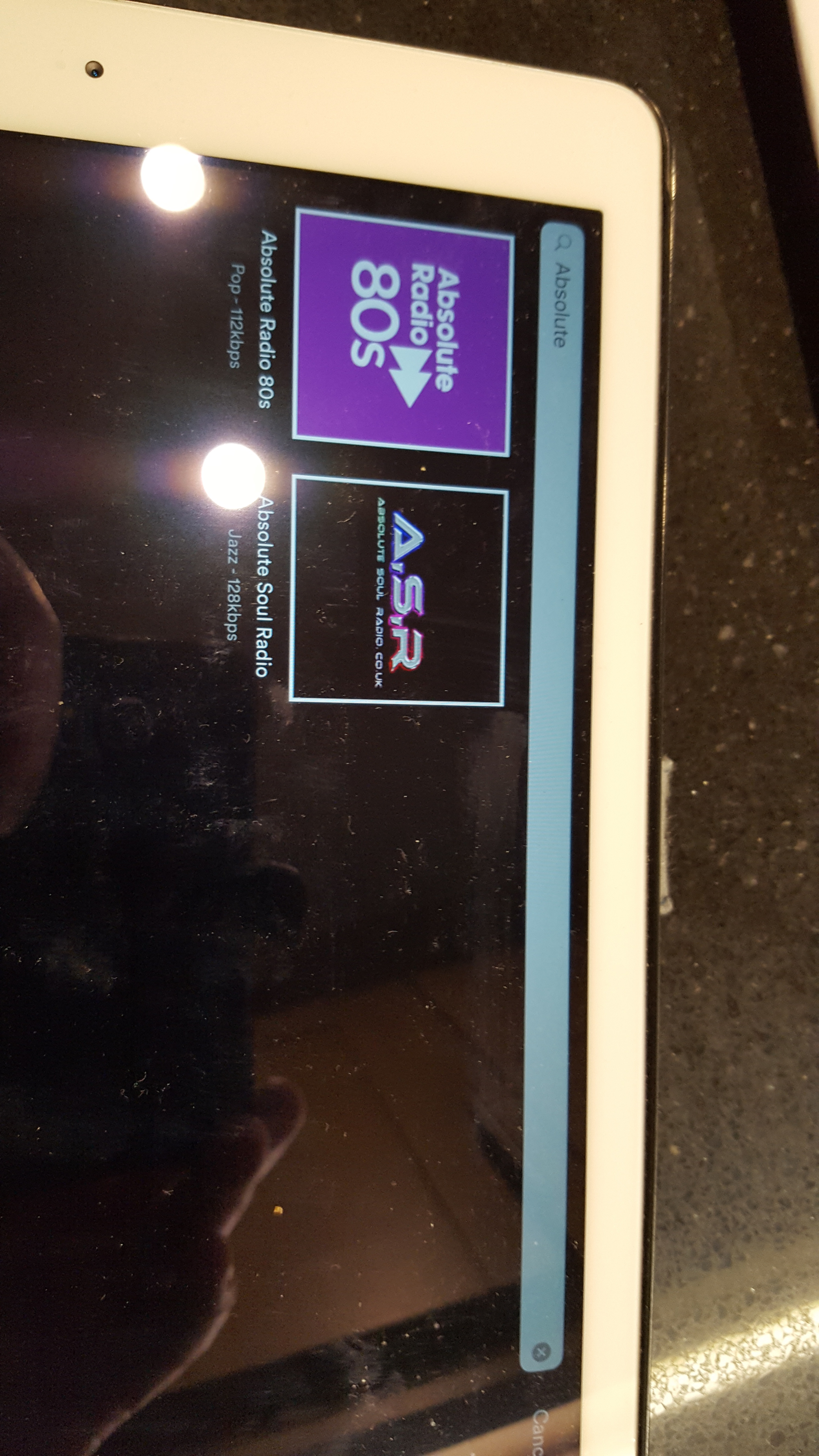

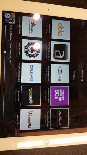

Unfortunately I can still see only 2 in the app. Firmware updated to the latest version a couple of days ago. Bit disappointing that my humble Pure can do what Naim cannot.

Can you post a screenshot showing where you can only see two stations?
Thanks for the input so far. Bought in 2012. Updated to the latest firmware a few days ago, which involved a factory re-set. No idea about the board though. I’m looking at the list of stations specified as All, and also doing a search on the word Absolute. Will post a screenshot later.

The reason you can’t see those stations is that your unit has the very first 2008 Streaming board in it, that can’t handle AAC encoded radio stations - only MP3. Most of the Absolute Radio stations in VTuner are now on the AAC streams, as they’re better quality.
