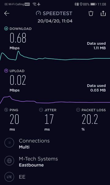

I’m in almost the exact reverse position here in rural Kent; no fibre but a reasonable 16Mb ADSL connection and awful mobile coverage. A good proportion of the time I get no signal at all but when I do this is typical. If I could get 30Mb on EE I’d be very tempted to get a 4G router but alas…
