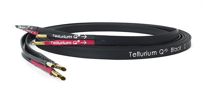

Tellerium black ? 54 GBP / m
Works well with Naim

That’s helpful! If I can just get them to answer my email. I have to hound them sometimes.
Tellurium manufacturer reports to US importer that they are concerned that for the length I need, plus the current drawn by the Magicos, the gauge of the wire in these is just too thin. I will take their advice! They recommend Ultra Black II but I shall not be buying $15,000 worth of cables, this I know!
As much as I dislike cable companies that don’t publish specs, I really appreciate their honesty here. Stark contrast to QED who apparently claim 16AWG is good for a 100m :frowning:
