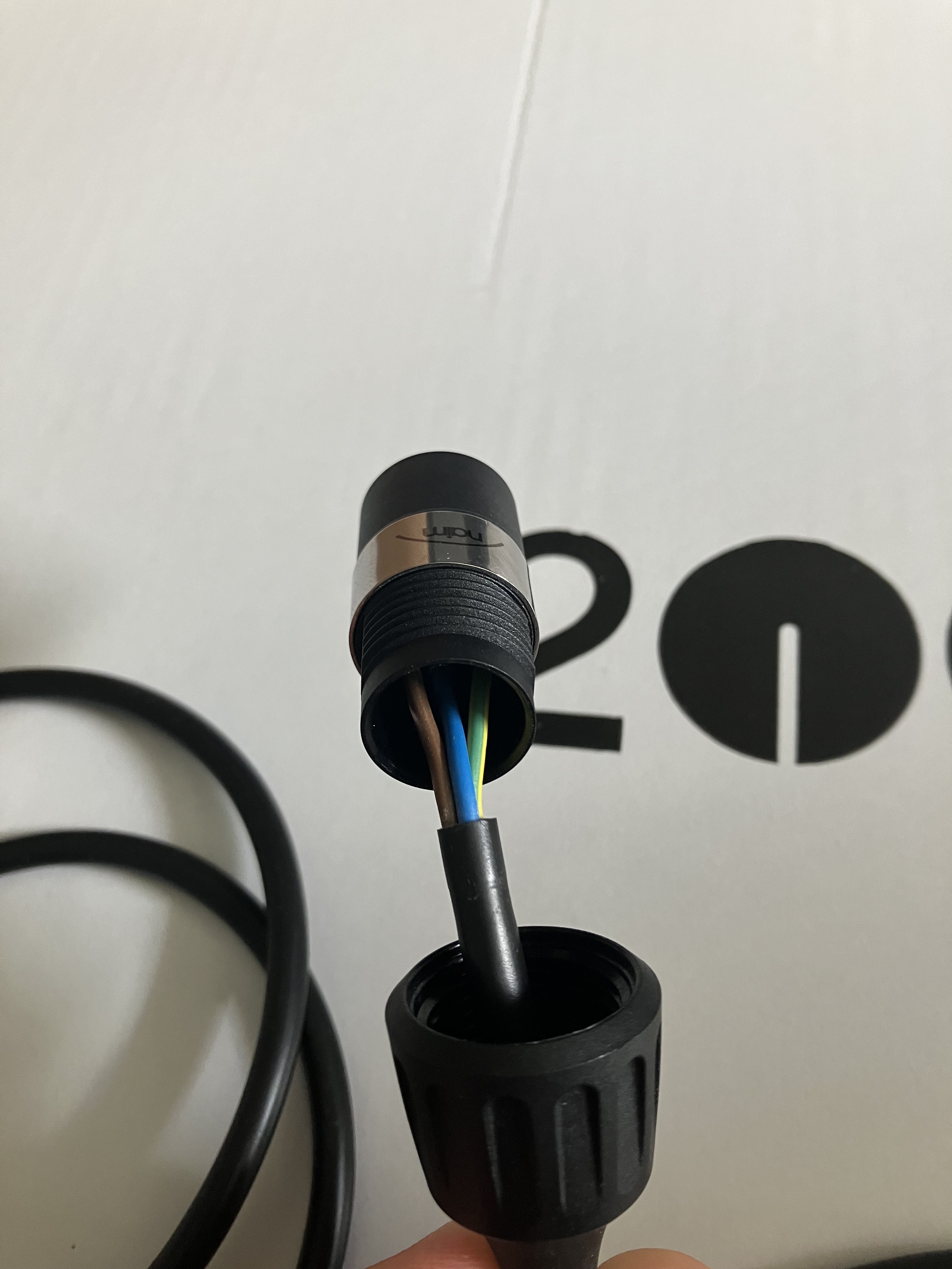

…in response to those asking what the NC NAP250 bundled interconnects are…
A pair of these custom Neutrik terminated mains flexes!
Line (Brown) to XLR pin 1 - HOT
Neutral (Blue) to XLR pin 3 - COLD
Earth (Green/Yellow) to XLR pin 2 - EARTH (would you believe?)
…it’s an amusing re-purposing of a mains cable.

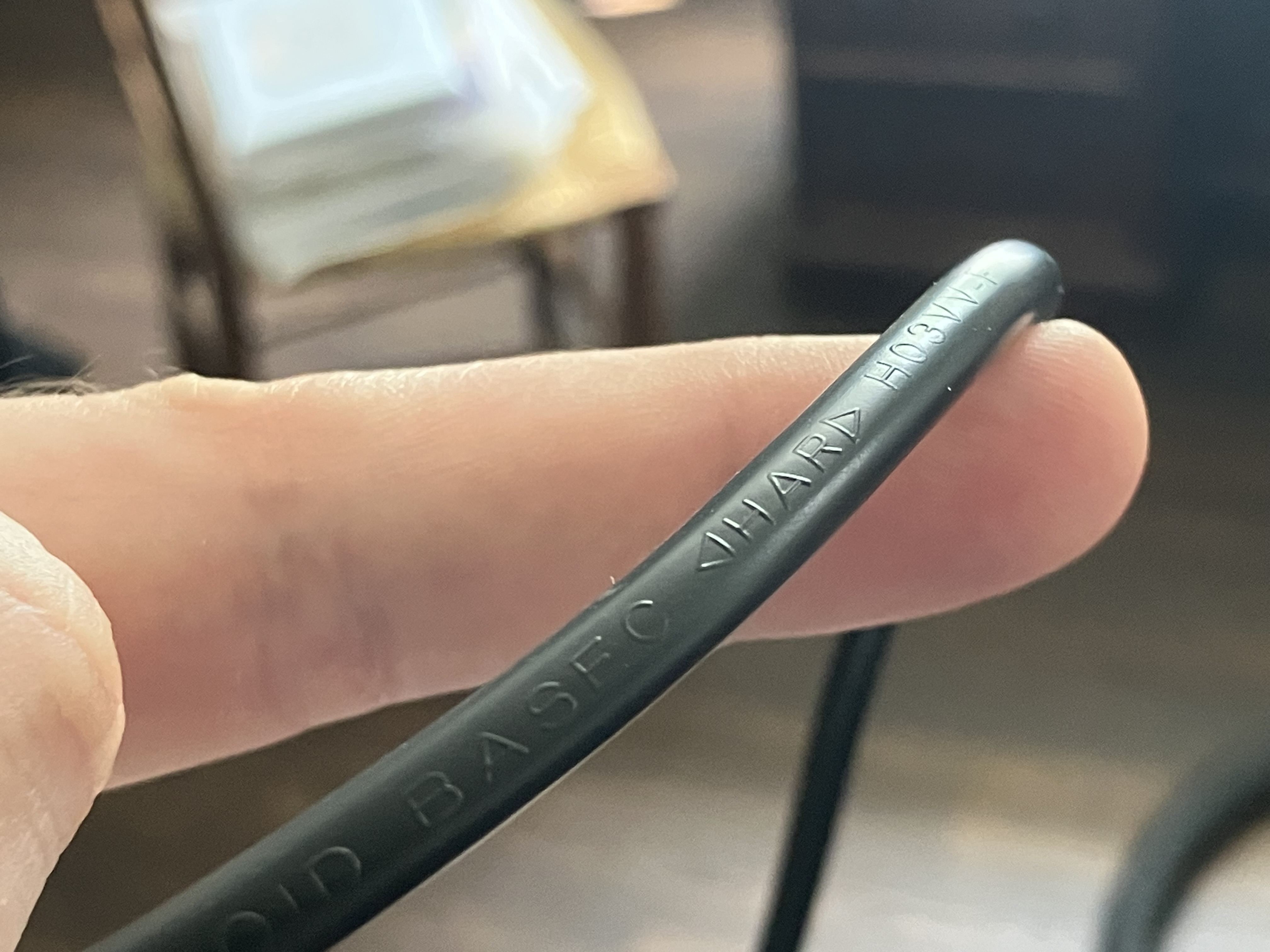

Looks like Powerline cable but thinner.
No, powerline cable has a rubbery jacket and is custom made high end cable.
This is BASEC H03VV - F mains flex.
For those not electrically aware, BASEC standardise the twin/earth cable in your walls for your house wiring.
Based on cursory research, the actual cable is probably Permanoid 2182Y from their online catalog. They make a lot of cables.

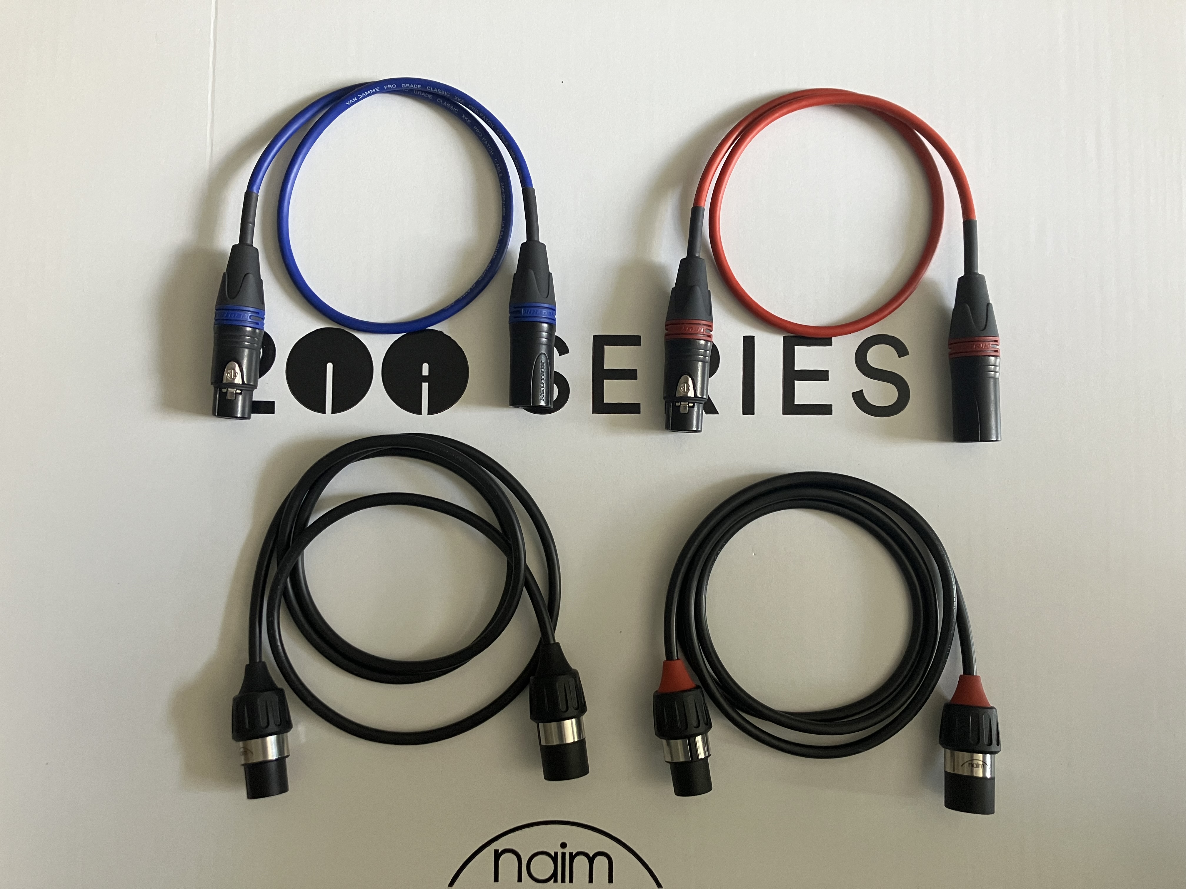

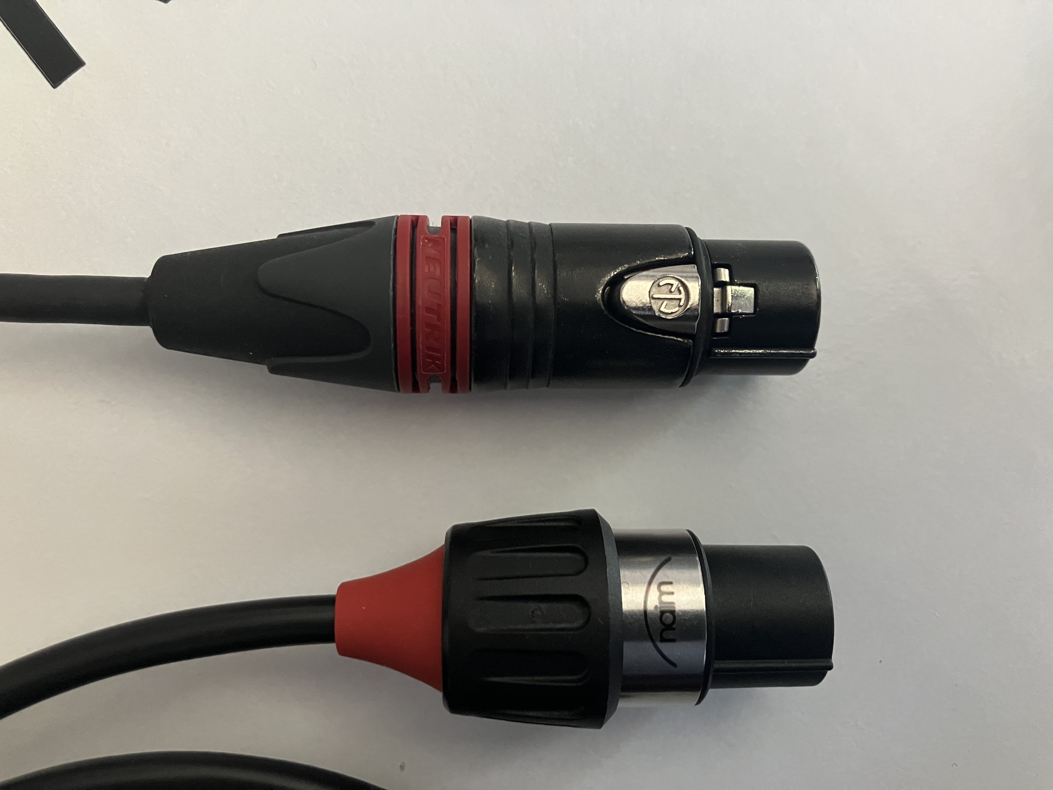

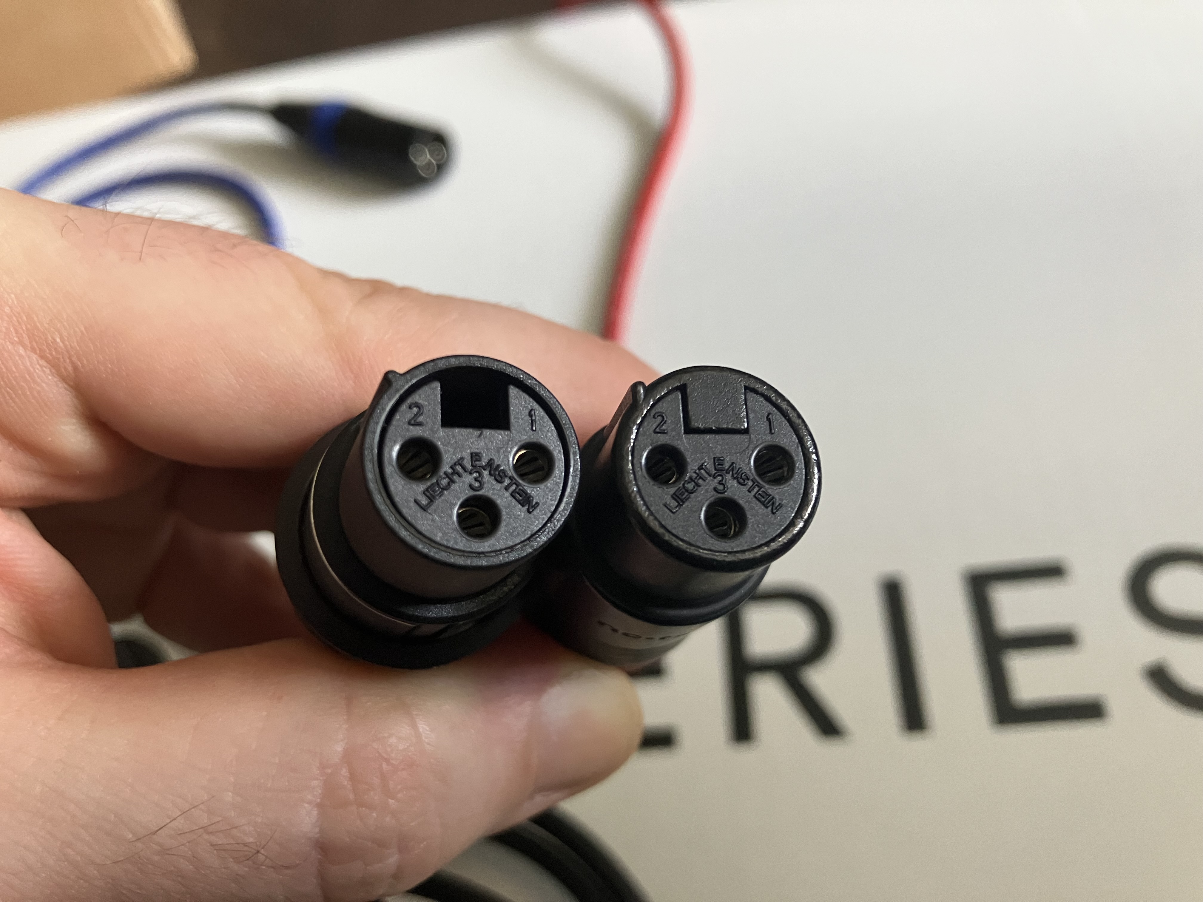

It’s actually quite an interesting connector…Naim say they have custom de-coupled the Neutrik from the shell, which if you look carefully…they have…the 3 pin/3 socket part of this connector is indeed a Neutrik silver, matching the Neutrik sockets for balanced audio in the NC Kit (and also Atom HE).
Naim have put the Neutrik pin component in their own plastic housing which is clipped and not screwed, so the pin/hole component moves freely of the housing forward/backward by about 0.5mm.
In a standard Neutrik MM connector, which this component comes from, the shell and connector screw together as one big solid sandwich…

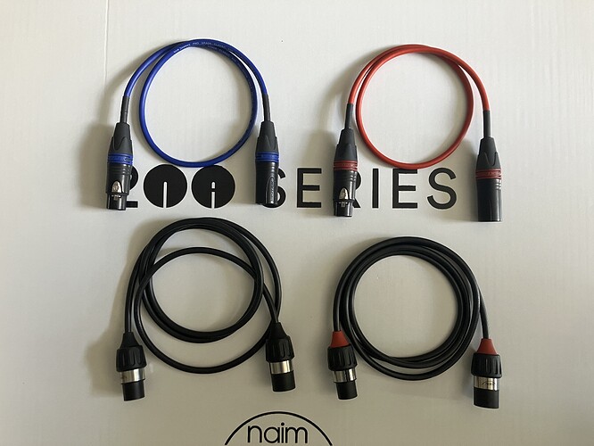

Some pics:
Up top: My own handywork - Van Damme Pro Patch into black neutrik MM’s with silver connectors - 0.5M
Below: Naim included 1M cables. Notice identical connector component (within housing)
