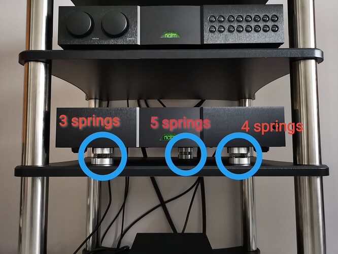

It is not leveled as the weight distribution of the component is not uniform at all four feet. Most of the weight of the component will be contributed by the transformer, and to keep the component somewhat leveled especially when using three Oreas, some adjustment to the placement of the Oreas will be necessary to not only prevent the component from sitting at a slant angle but optimise the efficiency of the Oreas.

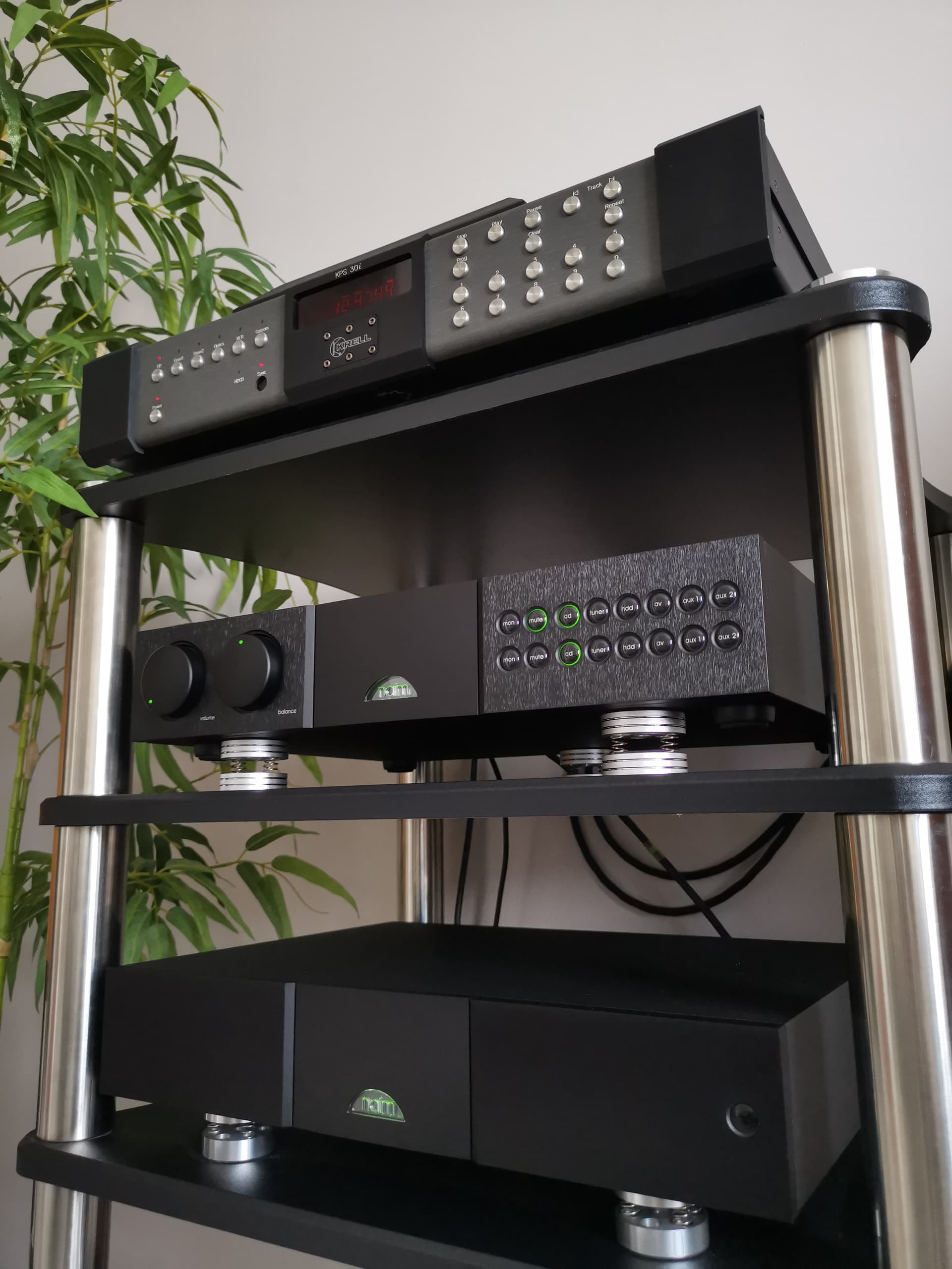

I have the Nobsound footers below components. Notice that the 3rd footer at the rear of the component is placed at a position to keep the component leveled. The number of springs of the footers are also adjusted to maintain the same gap/compression at all feet. A uniform gap or compression of all the footers will indicate that the loads are evenly distributed. I believe the Oreas also work on the same principle.
I see a Krell. Is it new ?
It is an old one, must be close to 15 years. Before this it was sitting dormant on the display rack for several years so I put it in the system to give it a spin. Rarely played though.

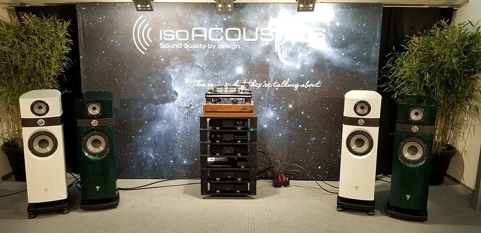

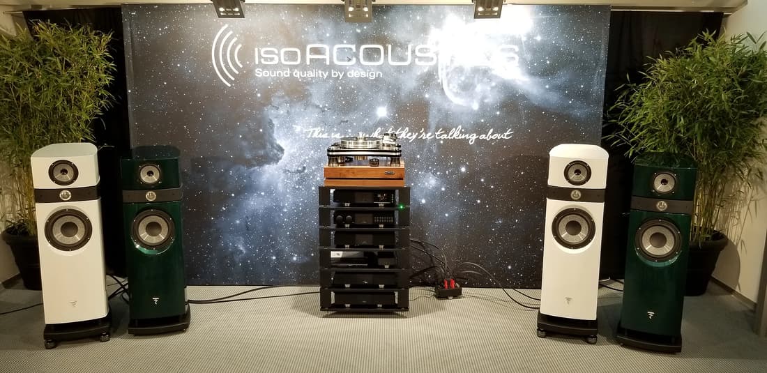

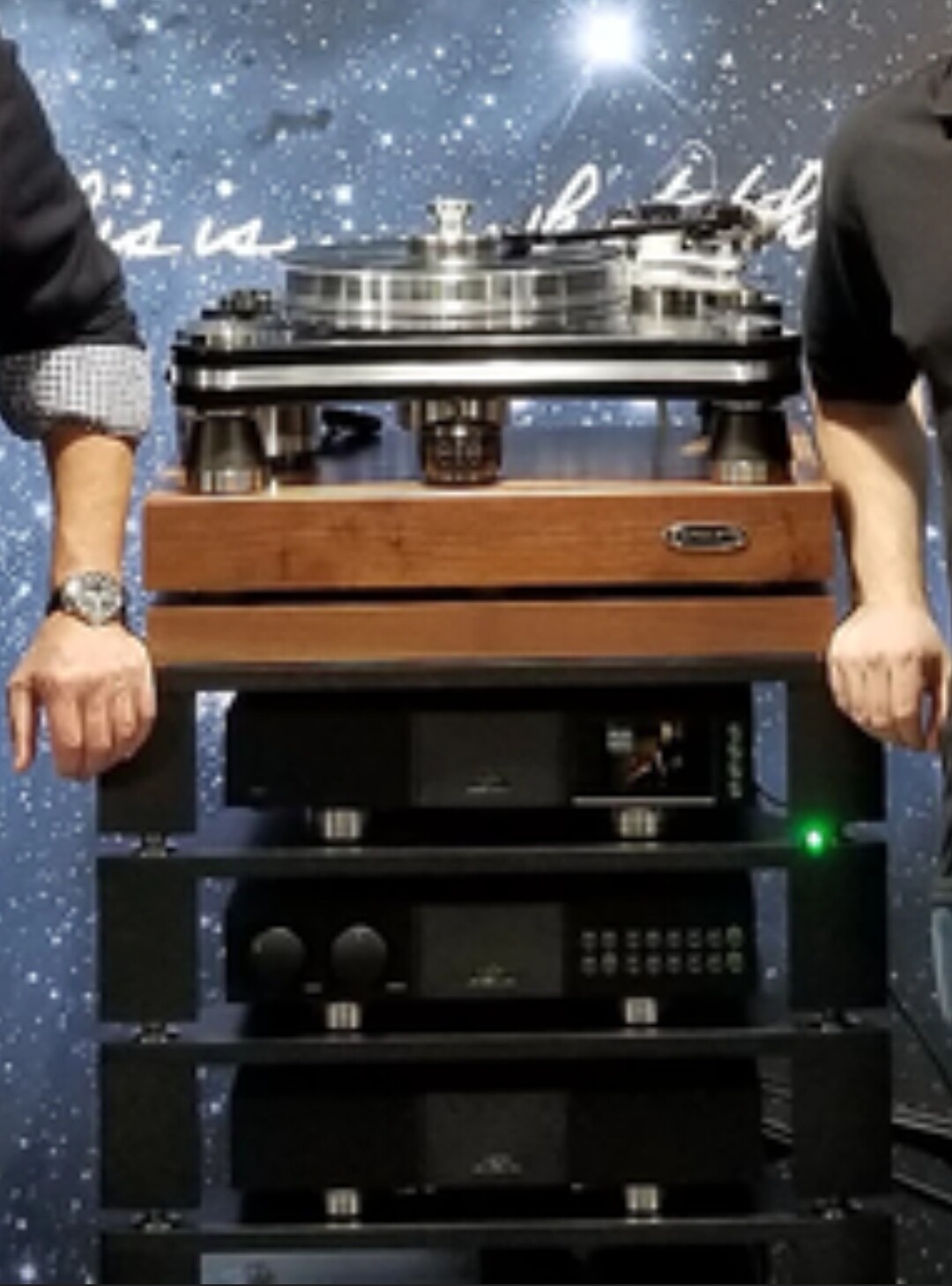

They put them below the case instead of the feet.
It’s not that easy, because you have to be sure that the atom will sit on each footer correctly. If not one footer can be under loaded, if you understand what I mean.
Yes, I can understand after spending some time with the installation of the Nobsound footers. I am not sure on the methods to gauge the level of compression with the Oreas to ensure an optimal support load (or perfect level of the component) is achieved. With the Nobsounds, this can be determined by the gap between the top and bottom metal pieces.
It is surely not a very easy task to place the footers below components with unequal weight distribution due to the placement of the heavy transformer on the right or left etc. There is no other way than to experiment by trial and error. In my case, with the Nobsound the footers are moved around until the gap is uniform ie. equal compression between all footers. In this case the footers will not sit nicely symmetrical between left and right, front and rear.
I’m not sure how the adjustment with the placement of the Oreas is carried out though since the compression at each footer is not visible to the naked eye / cannot be measured.
