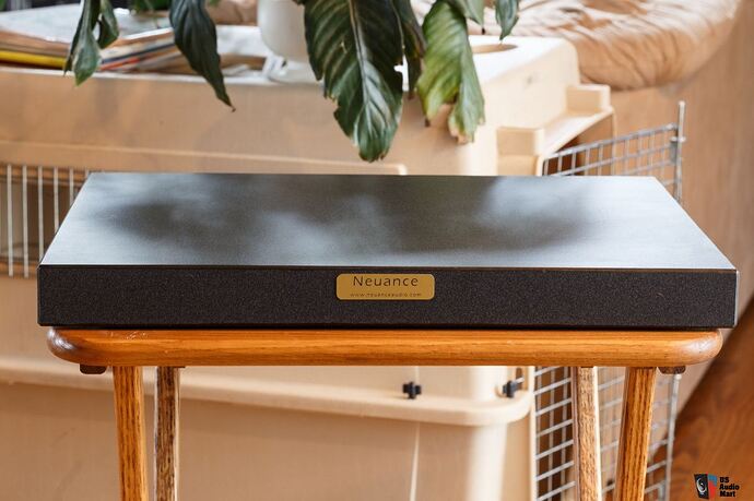

I found that the Absolute sound review of the Woodpecker uses a Neuance isolation platform, to great effect apparently.
Around 2kg. 175 dollars.
Answer: According to the Neuance website, the platform is described as: “…[a] low mass, internally dissipating design [that] augments your components’ own resonance control functions. Neuance preserves the pace, rhythm and timing of the original musical performance, offering an organic, natural and balanced presentation. The result is a product that reveals the music’s dynamic, kinetic and emotional qualities.” A pretty lofty claim. Is this hype or is it true…?

The Neuance platform is a nice piece- rigid but light taken to the extreme. Unfortunately, they have not been manufactured for many years now and only available on the SH market where they are difficult to source.
They are best used for LP12’s and Rega tables where this type of platform can reap big benefits. Not sure how well they work with a mass loaded turntable design…
I use mine under a LP12 on a TP wall shelf in the place of the supplied mdf shelf. Works very well :+1:

I don’t know how effective it would be under the Woodpecker, just read that Absolute sound reviewer uses it in his review of that deck.

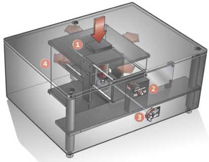

If one day you want the best for the SME, go for Minus K platform . Some say it’s really a must. But 2500 dollars, if not more.
You might also want to consider SRA, Silent Running Audio
