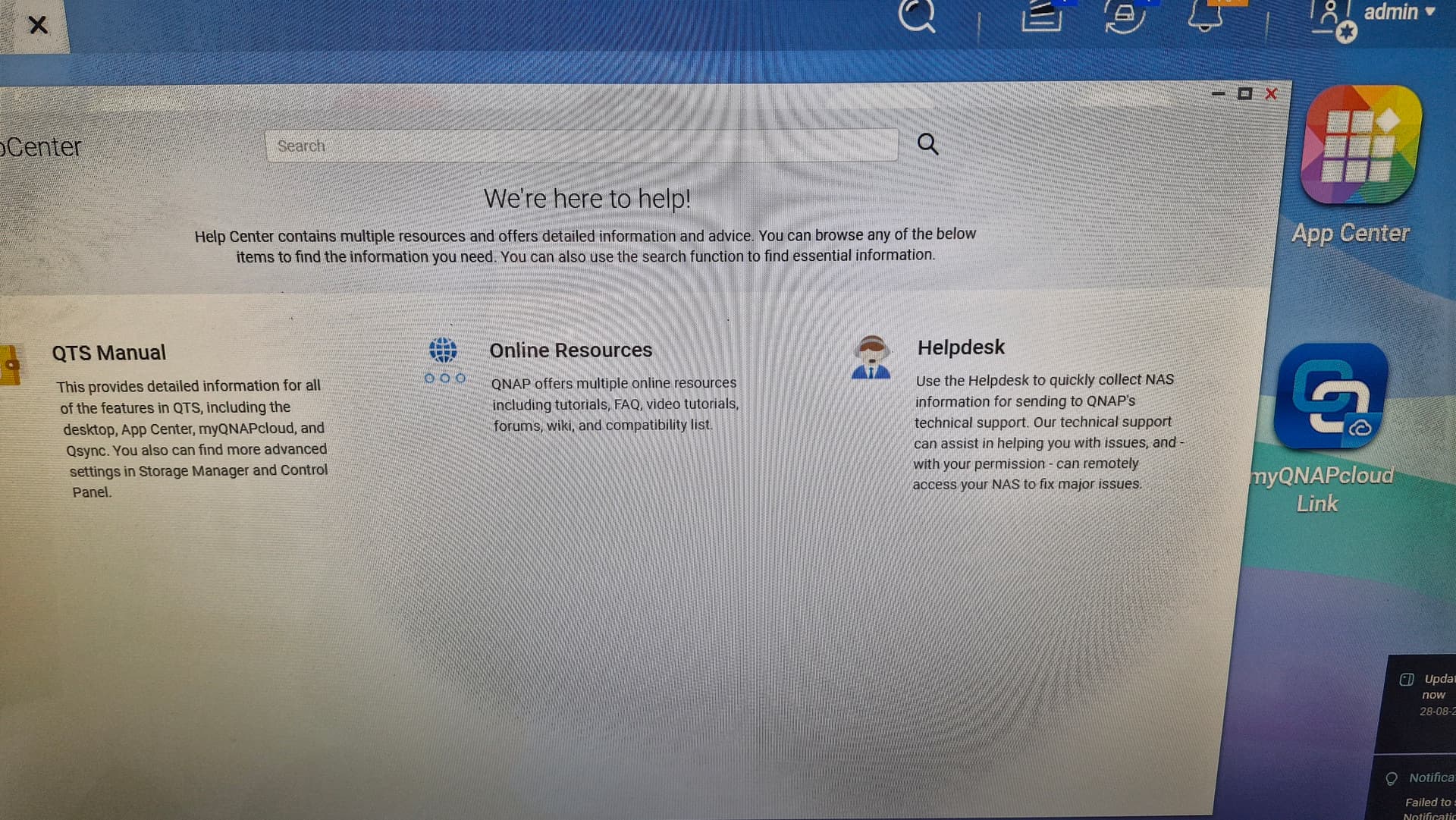

Hi.
Log into your NAS and submit a ticket through the HelpCentre. I did this when I had an issue and QNAP where helpful and sorted the issue out, and it is all free.
