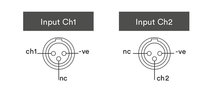

Although the NAP500 sports XLR sockets, these are still single ended so you need to use the RCA outputs on the KDSM and have suitably wired RCA to Naim pin out XLR cables made up.

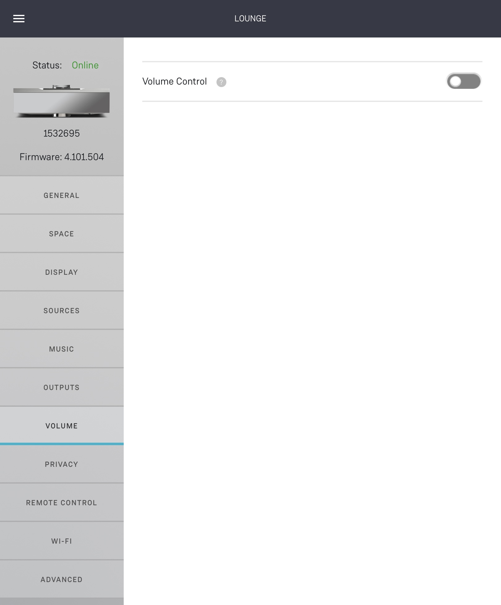

Other than that, set the KDSM into variable volume mode (shown off on mine as I’m using it as a fixed level source) and you’re good to go.

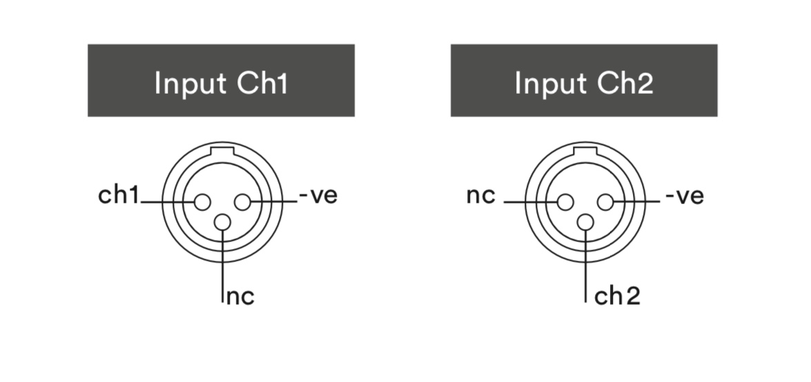

Wiring is very simple, but note that the Left (Ch1) and Right (Ch2) XLR sockets on the 500 (and 300) are wired slightly differently to each other. Your standard DIN4 to XLR cables have Green and Red bands on them which differentiate which cables are Left and Right respectively to ensure you use them with the correct socket at the amp end.
Left RCA centre pin connects to XLR ch1, RCA outer to XLR -ve.
Right RCA centre pin connects to XLR ch2. RCA outer to XLR -ve.
