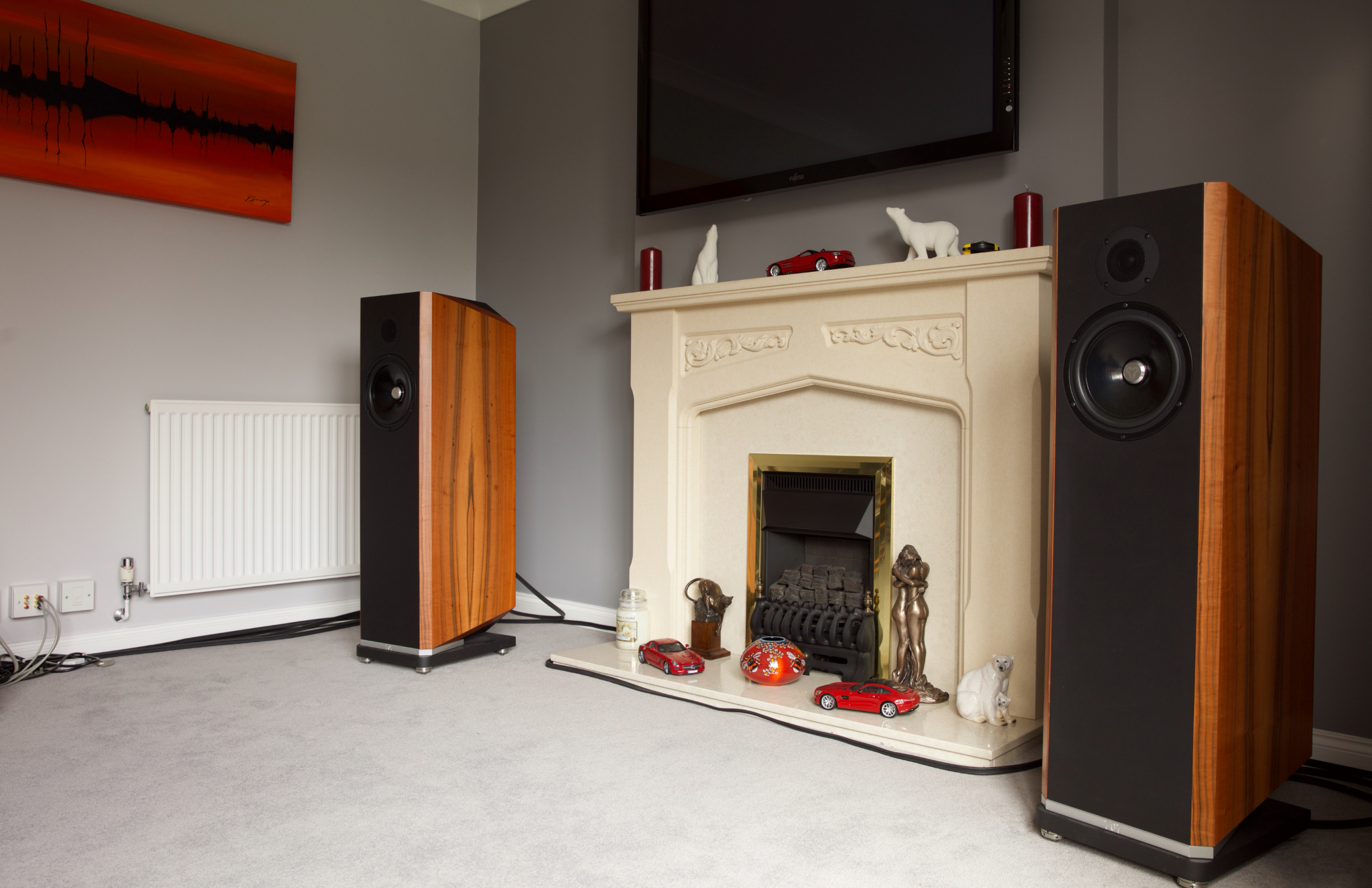

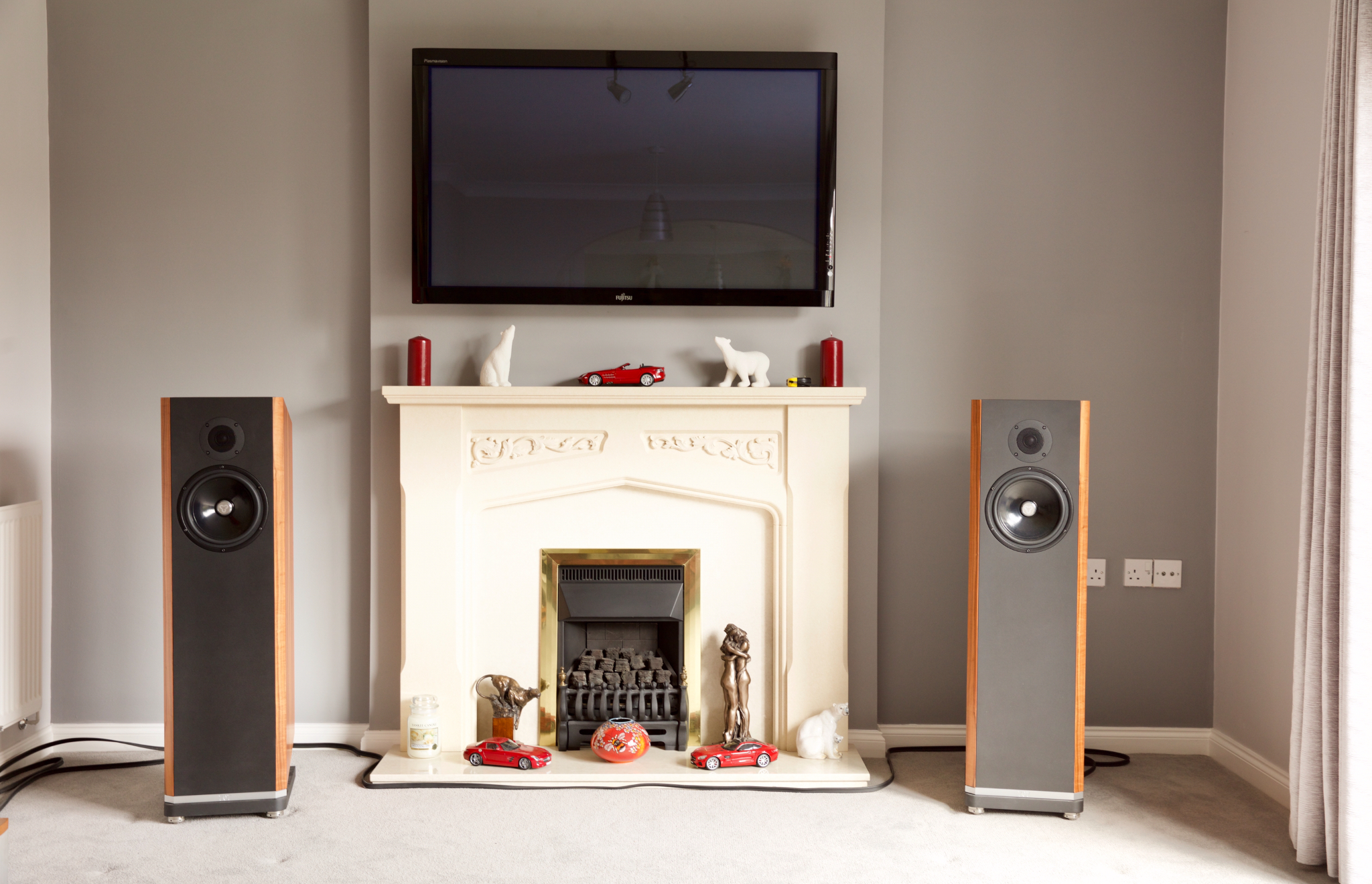

This is how I had the 707’splaced when I had them at my house.
the left corner doesn’t create bass distortion ? just curious
No, not at all, there is enough distance between the radiator and speaker to avoid any distortion.
