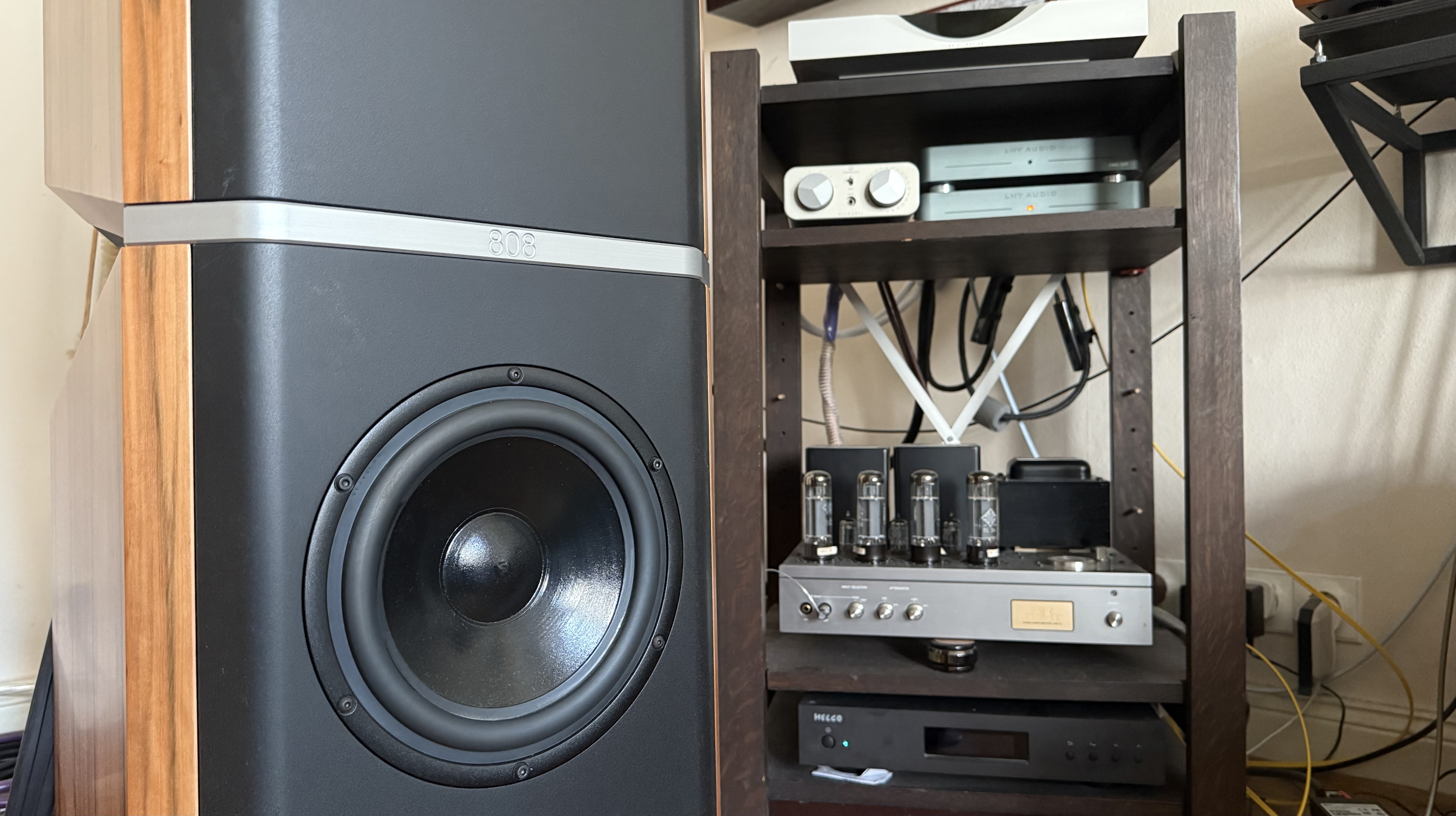

I have absolutely marvellous results with an Air Tight ATM-1s / Kudos 808 Combo.
Highly recommended. No lack of power.
Tried also
Klimax Stereo → was not convinced
Lejonklou Stereo → loved that amp
Air Tight : the best (with good, say: not original!, tubes!)
(Telefunken/Philips)
