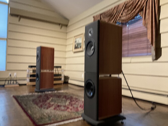

Mine like a little breathing room
Maybe not the latest Titan but they sure sound goodā¦.really good.
David
Sorry for the lousy pic quality
I hope the music is clearer than the pictureā¦
I bet they sound great with that space around them. I tried my speakers pulled right out and they sounded great. They just canāt stay like that though as we need the room for living ![]()

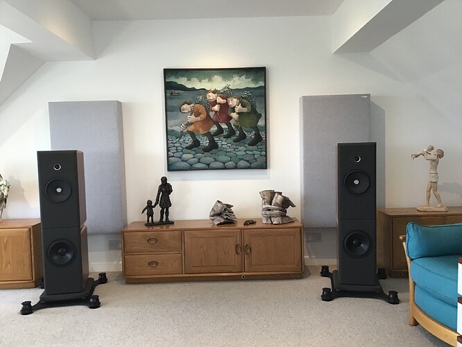

Previous speakers being Linn Saras & Isobariks, the mantra was āfollow the tuneā and that continued to be one of the benchmarks when changing to the Titans approximately six years ago, placing them close to the wall (though not as close as the Isobariks).
Seeing other forum members off the wall Titan placements I decided to experiment for myself, this revealed a convincing soundstage, but still retaining everything I had come to enjoy in my listening.
Hence my view is, yes Titans are room friendly and work in close proximity to the wall but excel when given room to breathe.Soundstage was never the main criteria for me, and still isnāt, but one doesnāt need to be at the expense of the other.
The introduction of the podiums and absorbers came later.
