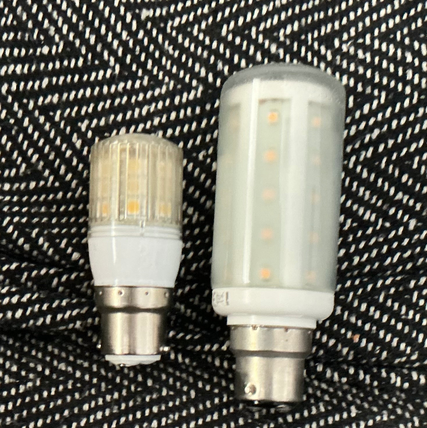

I’ve been using corn bulb led for quite a while.
Warm white.
Actual rating 8W for nice old “big light “ equivalent and for small lamps 4W actual rating.
They run very cool too.
These are about eight years old.
360 light not 180 upwards
Loads on the flea bay.

Corn bulbs have their place. Bear in mind they don’t throw a lot of light out from the end. Also, due to the number of small leds, they do tend to be quite poweful which can lead to a fair amount of heat. This heat can cause stress to the driver and fail.
Thanks again, I’m looking only for g9 lamps and as it happens these all seem to be ‘corn’ designs but will always have 360’ dispersion anyway.
