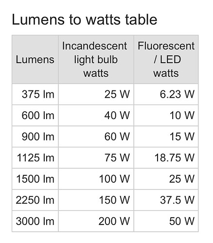

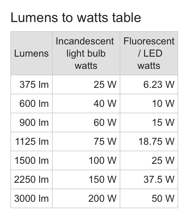

This might be helpful
Light Bulb converter

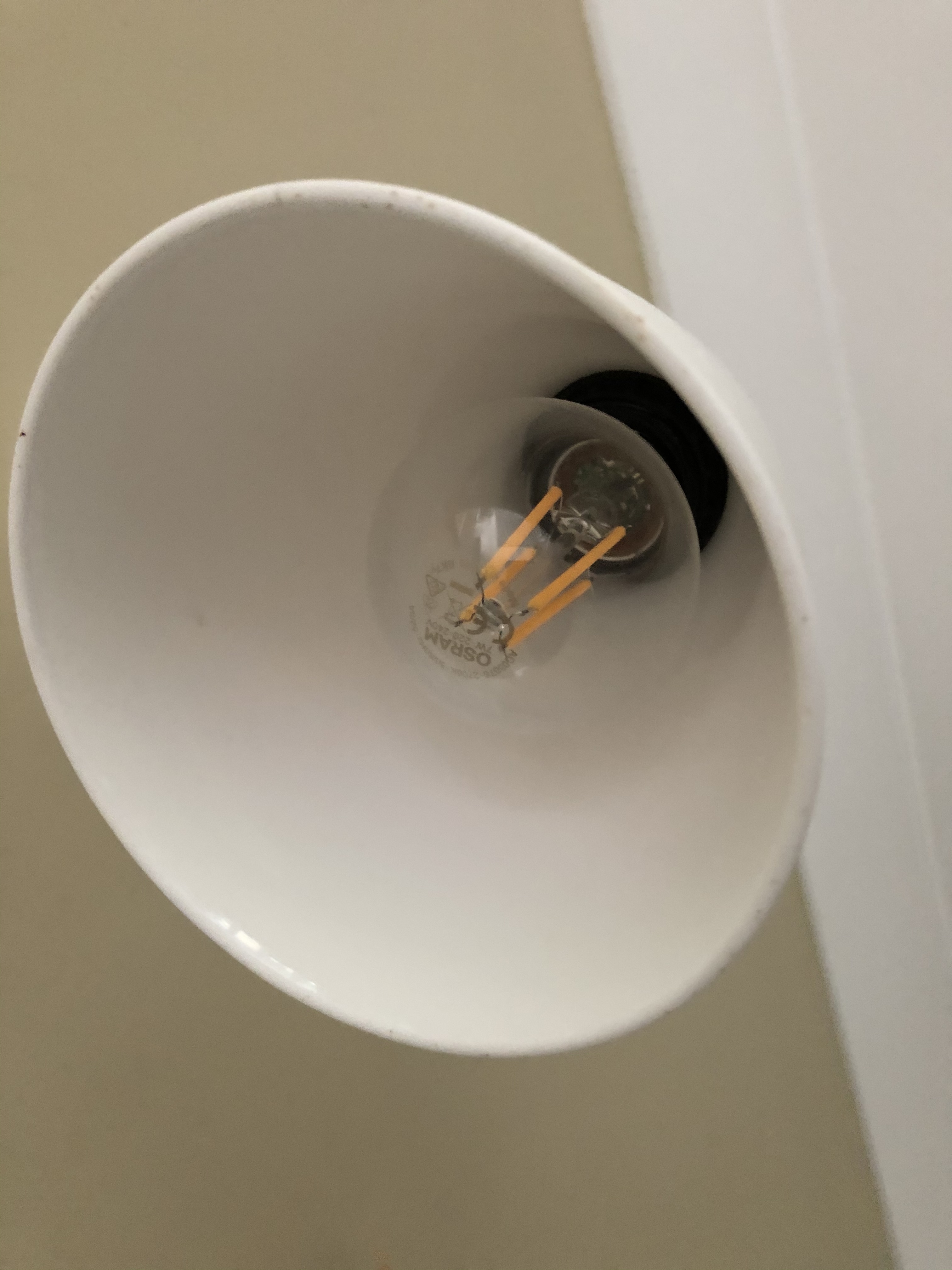

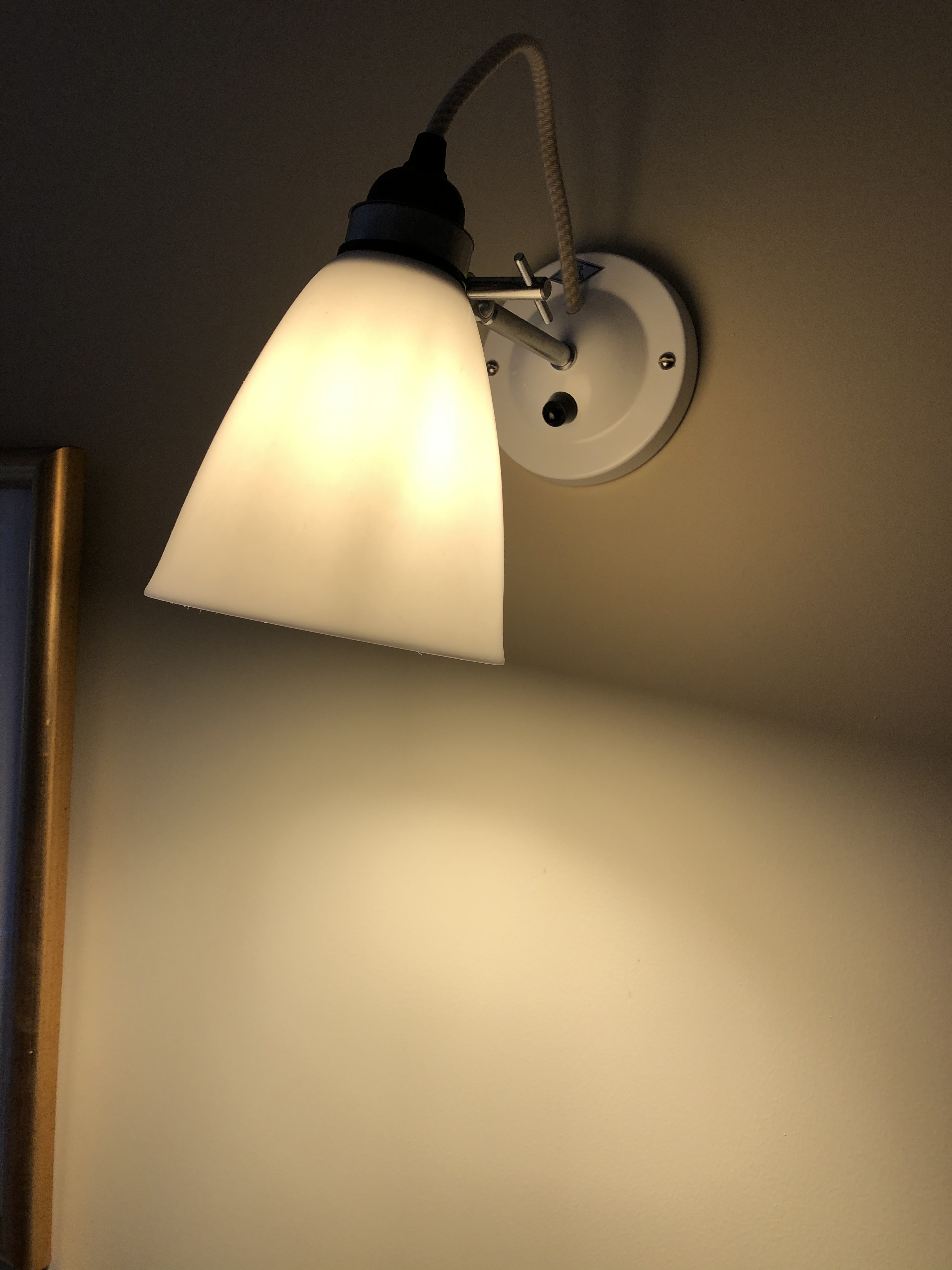

We use these Osram bulbs. They give a nice warm light. The wall lights have 7w bulbs and over the table we have 4w. There is also a pearl version.
I like the ‘filament’ type LEDs which look much like an old tungsten bulb. There are quite a few brands out there. Go for the 2700K warm white ones, and they will have a reasonably warm light that’s not too different from an old fashioned light bulb.
