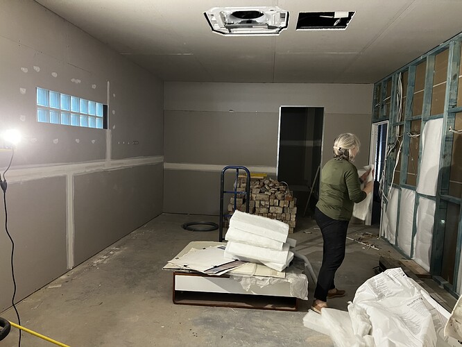

I’m ready to install lighting for my studio and unsure of the best options. I’ll have down lights but was hoping for a system that will reduce shadows and create a natural/neutral light.
Anybody got any ideas.

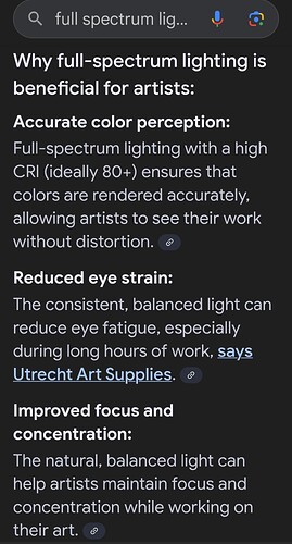

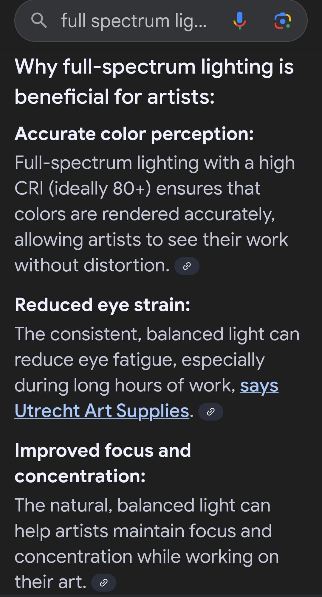

It’s not that complicated. Lighting with a CRI above 80 is recommended, 100 is the max.

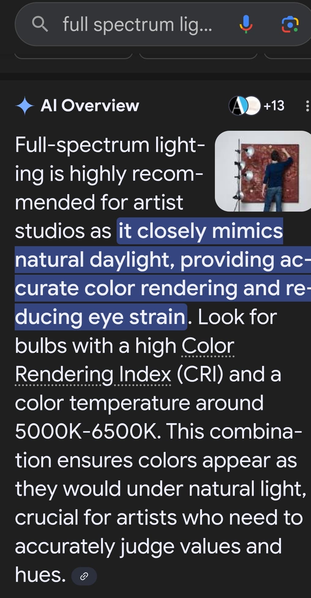

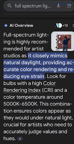

According to the AI on my phone. ![]()
Looking at adverts for full spectrum lighting for artist, they are specified as CRI 95+.

What is behide the glass blocks, is there room to put either Tube lights
Or LEDs ?
