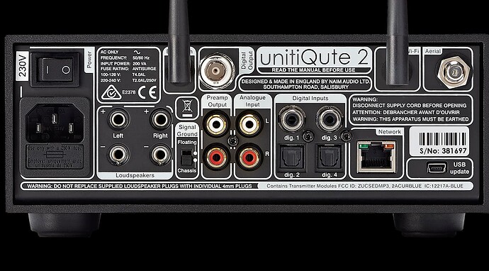

What’s the difference between the line out and preamp out?? I just got a SH NAC 172 and temporarily going to connect it to my UQ1 until I can find a suitable power amp. Assume the line out means I can control the volume with the UQ?

@Alley_Cat wouldn’t line out from the 172 into the UQ1 “Analogue Input” do exactly what the OP needs? The UQ would see the 172 as any other line level source. Albeit the 172 could itself have a source connected in addition to its internal streamer.
Use line out if connecting the 172 to a pre amp.
Use pre amp out if connecting the 172 to a power amp.
Yeah, looks like line out to the UQ so I can control volume from there.

Yep, it sure does. 172 line out into Analogue Input should be fine I think
Controlling volume on the Unitiqute means leaving the 172 page in the app and opening the Unitiqute page every time, which may be a bit inconvenient if you are using the 172 as a streamer. Still, it will work.

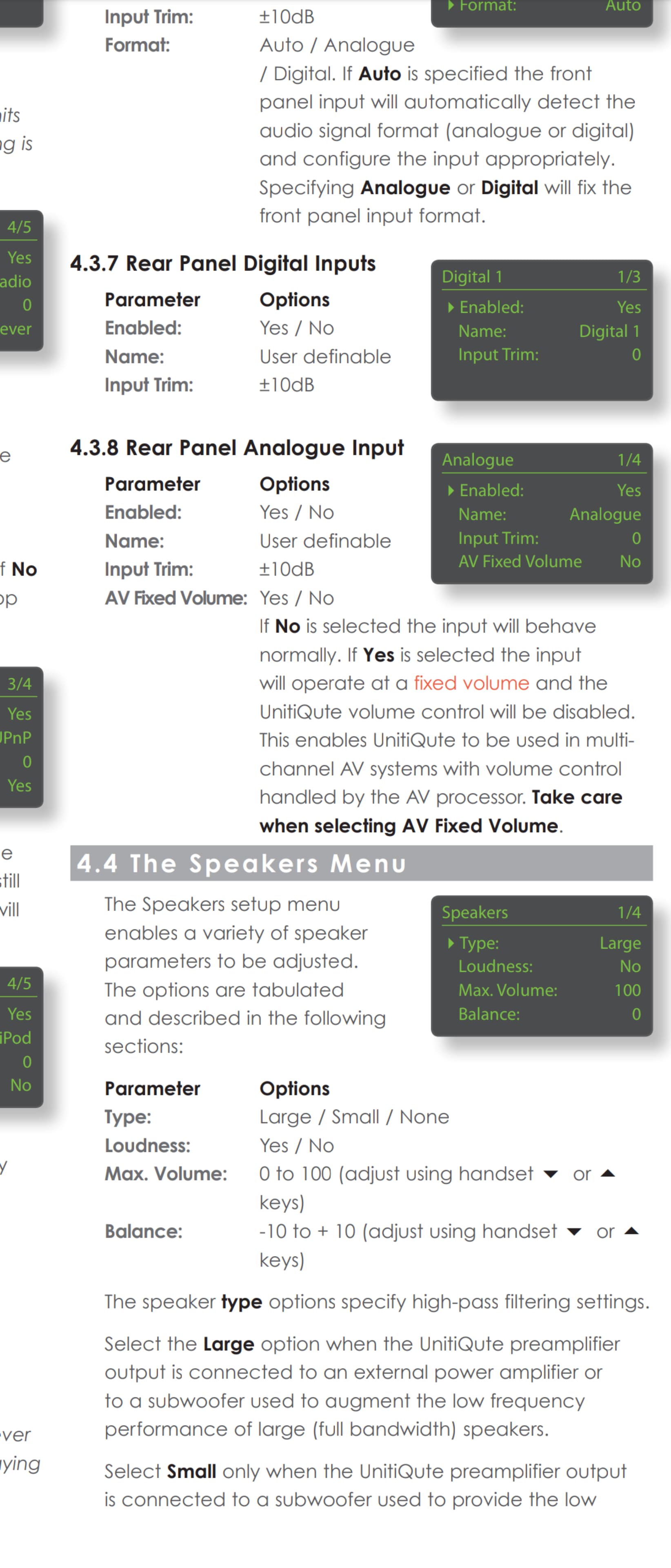

If you enable AV Fixed Volume on the Unitiqute you can use the 172 volume control, with the preamp output connection used.

JDP - thanks! That is EXACTLY what I was looking for. Now I can A/B the preamp sections between the 172 and the UQ - more weekend fun

Be careful when making these comparisons. If you use the Qute in fixed volume mode make very sure that you have the pre out from the 172. If you connect line out by mistake your ears will get a very nasty surprise!
