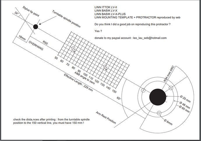

Does anyone here know what the centre distance is for spindle to linn ittok arm pillar centre, I really didn’t want to spend £58 to buy one just for one time.
According to Vinyl Engine website its 229mm
They have a template there as well but I cant seem to upload
Wouldn’t that be 229mm - 18mm = 211mm from spindle to center of collar?
Scott
Hi
Yes sorry misread the diagram but template shows the correct dimension
I’ve measured my Kinky tool!!
I can confirm the measurement is 211mm
Perfect, thanks very much guys, I can at least check it out now
