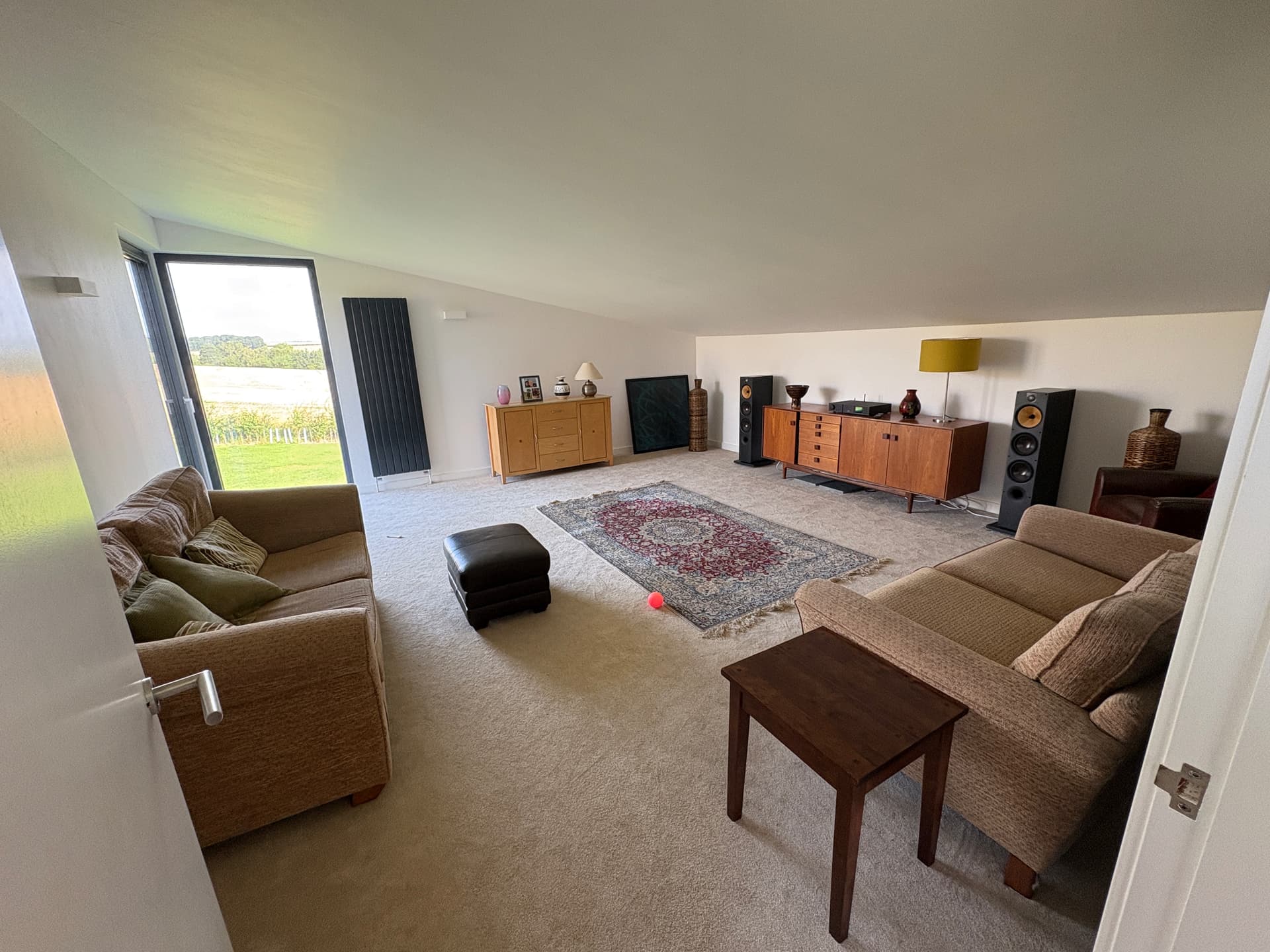

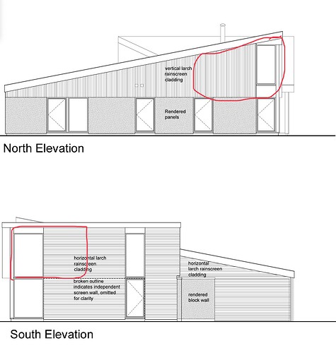

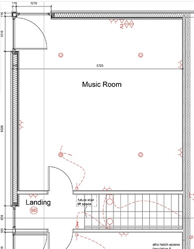

My listening room is upstairs in the roof-space of our new-ish self-build. It’s a mono-pitch roof, 2.4 m ceiling height at one side and 1.5m at the other. The room is around 6mx6m. I’ve never felt the sloping roof caused any sound quality issues. There are substantial floor joists with mineral wool insulation but sound still transfers to the room below. My wife originally had her home office in the room below but has now moved two rooms along and there is very little sound transfer now :face_exhaling:.
Most excellent :ok_hand:
Wow
A lovely looking space
Thanks, I’m very fortunate to have this space. We managed to furnish it using old / secondhand furniture etc.
A very nice space for a music room with a lovely view too :+1:
Mind your head when going for the volume control. Best use the remote :wink:
That’s a very nice looking room. Well done.
Yes it’s been bashed a few times. Thank goodness for the Naim app.
I had a loft listening room with sloping ceilings and had no problems at all. I moved home a few years later and built a brick listening room in my garden.
