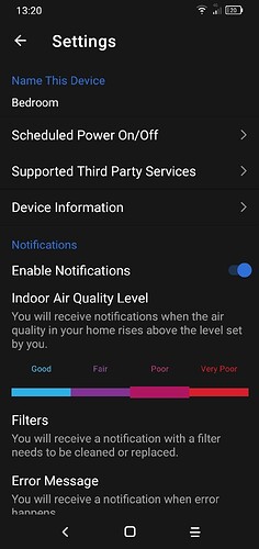

I have Philips air purifier. It monitors the air quality and sends a notification to my mobile if quality is poor.
The app displays historical levels, plus there is a link to a website that shows UK map with local AQ levels.
