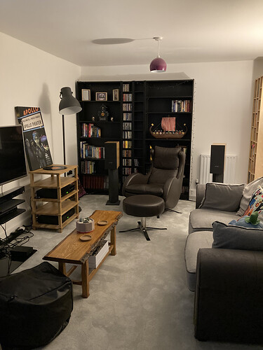

Update -
after a lot of different speaker positioning, ended up choosing the short wall. I think the room was just too narrow to make the long wall work and the sound was very ‘busy’
Put a large bookshelf behind the speakers and have finally got some curtains, which has calmed the acoustics a little but still need to reduce the echo. One long wall is completely bare so considering some GIK panels or possibly another bookcase.
