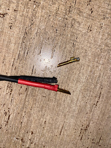

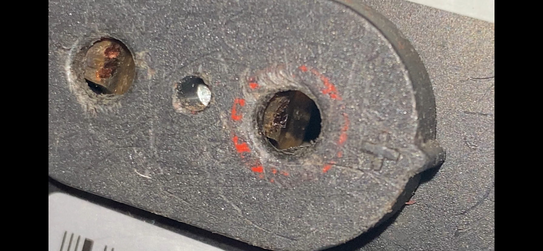

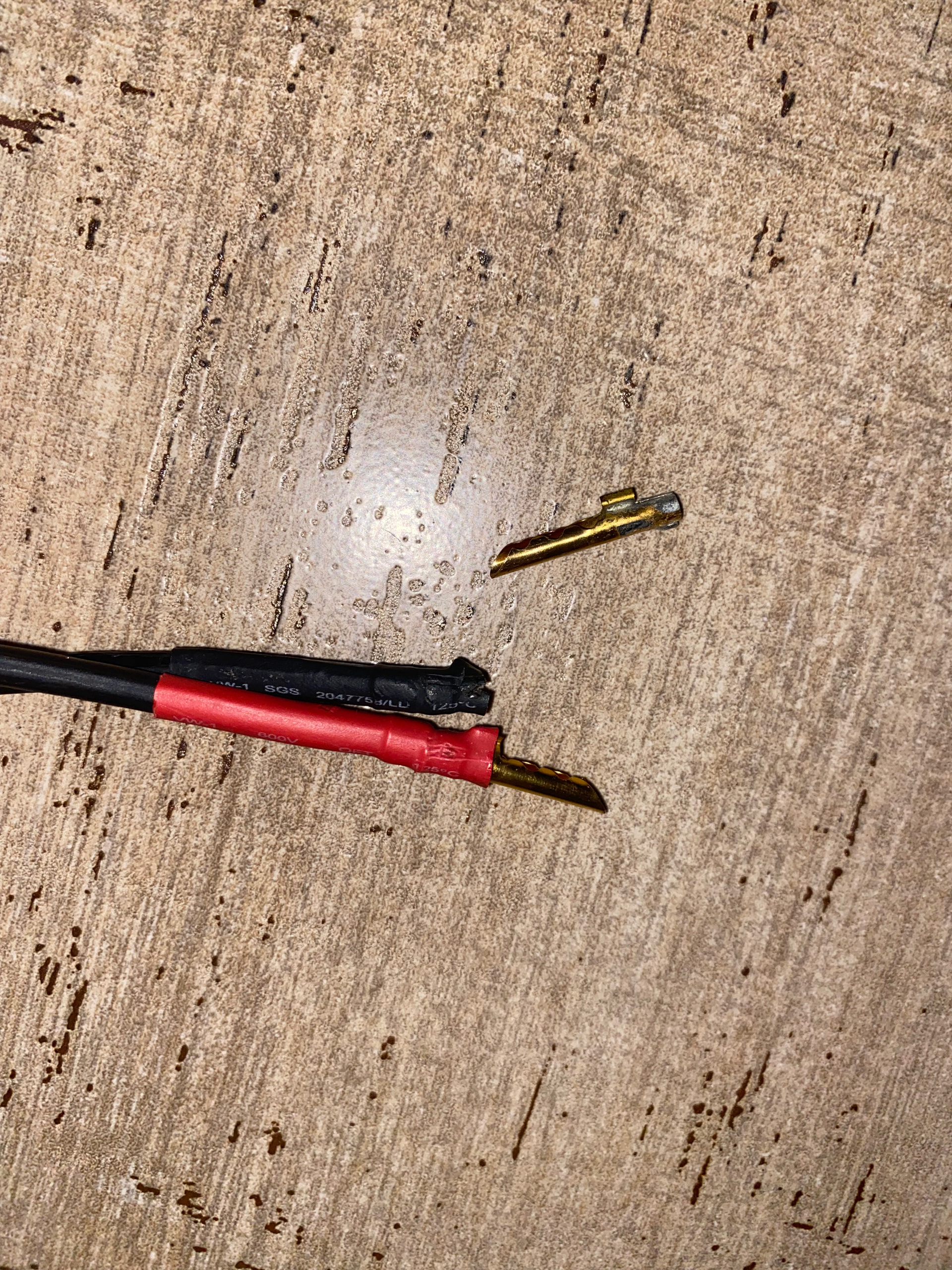

And I had a little accident. One end got detached from the cable. I also noticed that the inside of the contacts look quite dirty. You can see the attached pictures.

  1. Is it safe for the speakers to simply re-fit the cable by hand and use it, or does it need to be soldered back in place?

  3. How could I clean the dirty insides? Can the connector port be removed from the Ovator S600 for cleaning?
Don’t put the plugs back on without solder. Get some proper Ovator speaker plugs soldered onto your cables.
Those sockets look quite battered. You can clean banana sockets with a cotton bud soaked in a little IPA, taking care not to pull the cotton tip off the stick. Not sure those sockets don’t need more than just a clean though.
Thanks Chris, I’ll order the Ovator plugs and will keep the system off until I’ve fixed this.
No idea what to do with the ports yet. If they can be removed, I’ll be able to clean them properly.
The sockets look corroded to me. Maybe worth asking Naim support for advice. Maybe @NeilS has some suggestions?
I’m not a fan of those Z plugs you have, it looks like maybe the harder metal they are made from has removed the silver plating and gouged the copper underneath.
The sockets certainly look like they’ve had a hard life! I’d guess some “blind” connecting from the front of the speaker perhaps?
Almost looks like rust on the contacts inside.
Definitely recommend replacing the plugs, as for the sockets - not sure, start with something light, like a cotton bud & IPA. You may need to find something more abrasive if that doesn’t cut it.
Small, brass bristled bottle brush perhaps, but you’d need to be mindful of lost bristles though.
Here’s a shot of the rear of the socket on S600s - I’ve not assembled, or disassembled these before though.

This may help,
I’ve used a small round brass bristle brush in situations like this,
but I also recommend using a vacuum hose in one hand, and the brush in the other, hold hose under hole.
Start small working inwards, pull brush completely out every stroke, once you think you got it all, stick the hose over the hole to make sure you have not missed abit, then clean with IPA and cotton bud, hopefully be good to go,
Yes the picture paints a picture of a lot of crud etc but I’m sure it can recovered. Have just used the ear buddy idea on the terminals of my 200, and wow the crud that came out was mind boggling. Took several changes of bud to end with a clean socket
Took the opportunity to do the same with our Intro’s and not as bad but now clean. Polished the Naim speaker/ amp plugs withe same metal polish I have always used, wiped off with alcohol wipes

I can easily picture the previous owner (my father) doing exactly that: trying to connect them blindly from the front and failing.
