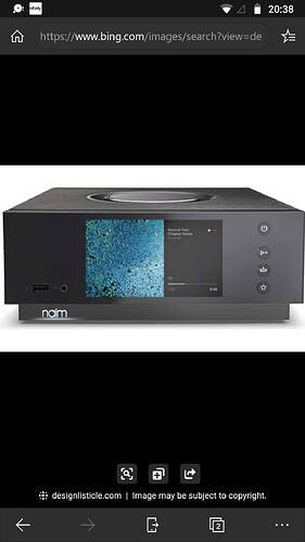

I have been the happy owner of an atom for a few months now. My only frustration is that the software seizes, too frequently for my taste. I mean, music plays from the last source, but the screen is stuck on a home screen. When this happens, the only remote button that works is the brightness button. The sole front panel button that works is the power button. The only way to reset is to pull the plug and reconnect. Is there a fix for this? As great as the Atom is otherwise, this drives me nuts! Thank you! Thanks
Thanks for your thoughts!
