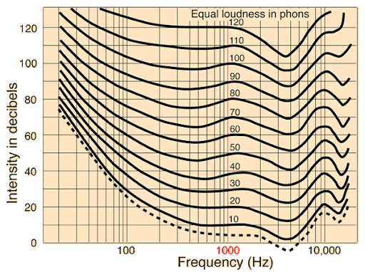

This chart shows human hearing equal loudness curves, illustrating how the curves vary with sound intensity: bass is relatively quieter in relation to mid frequencies if the net sound level is lower.
