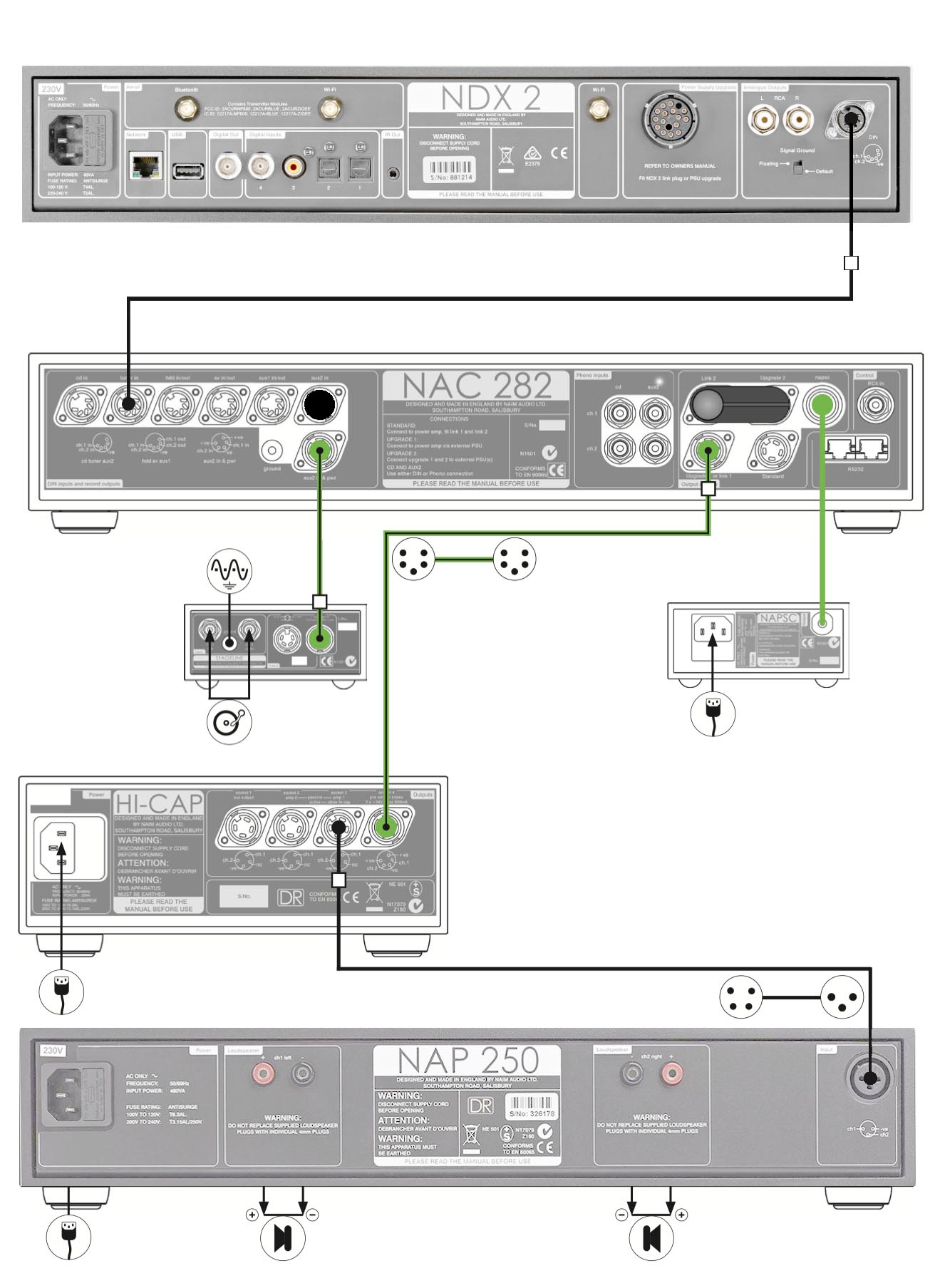

I have just upgraded my system from SN3 to 282/250 Hurray ! But being new to the setup, I am not sure about the LP12 volume I am getting. Any help would be greatly appreciated.
So, my LP12 is now via a stageline. My preferred listening volume is normally around 9 O’Clock on the amp and still is with the NDX. However, to hear at the same level when playing vinyl through the stageline, I have to adjust the volume dial to about 12 O’clock. Is this normal? Or have I got the wiring wrong? Attached is a connection diagram of my system in the Naim Style, have I got this right?.
It’s probably normal as the output from the Stageline will likely be a fair bit lower (usually around 300-600mV depending on cartridge) than from a digital source (2V). What’s the cartridge? Which Stageline?

Same experience here, and I think it is normal (exactly as @Richard.Dane said).
