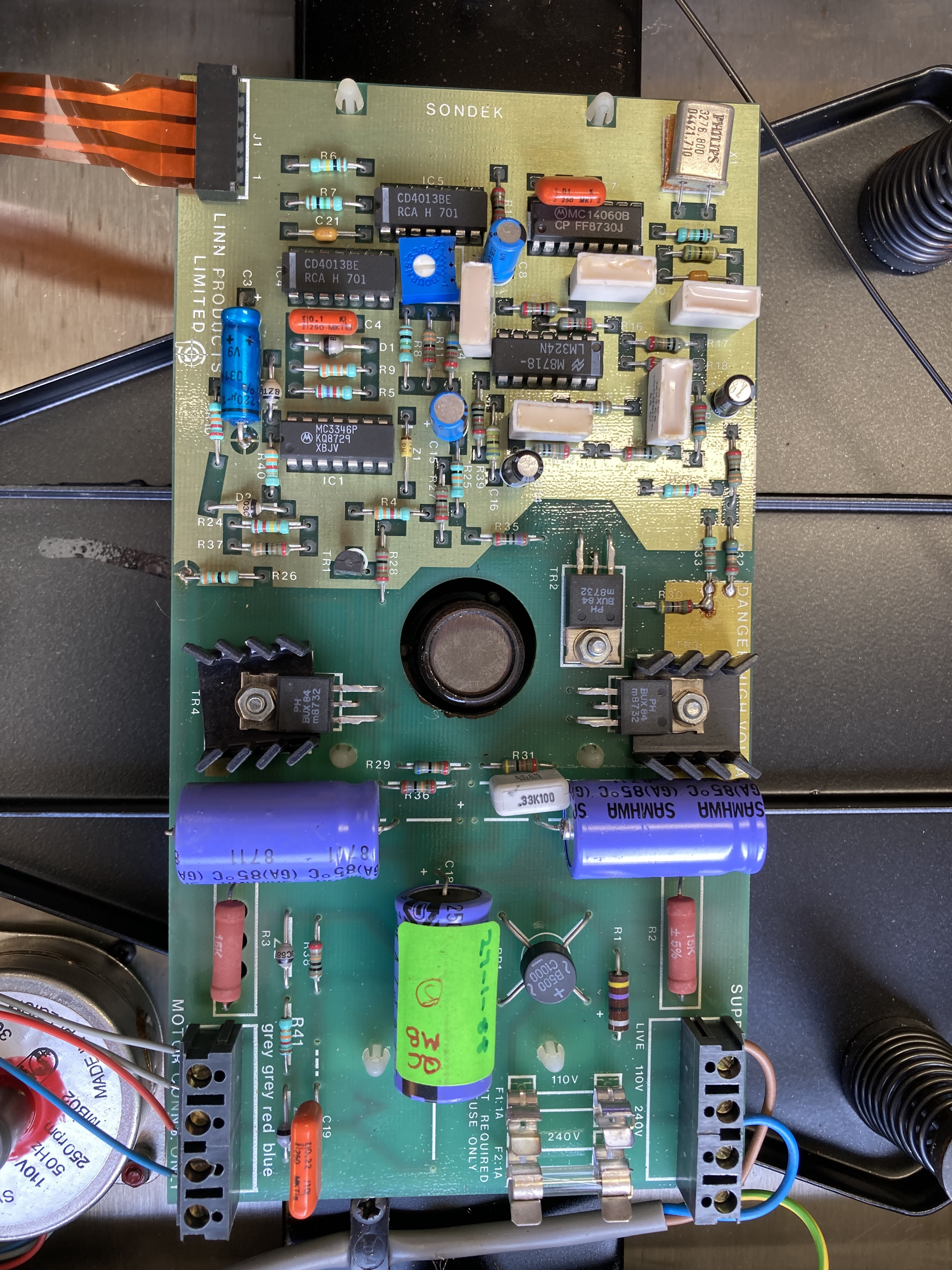

Before and after. :sunglasses:
Service is mainly the big Capacitors, the Power Resistors (adjacent to the terminal strips, black in top, blue in bottom) and the Rectifier Diode block (left of fuses).
Here is my now sold Valhalla board, pre service -
Note the blackening around the Power Resistors.

Post Service.
