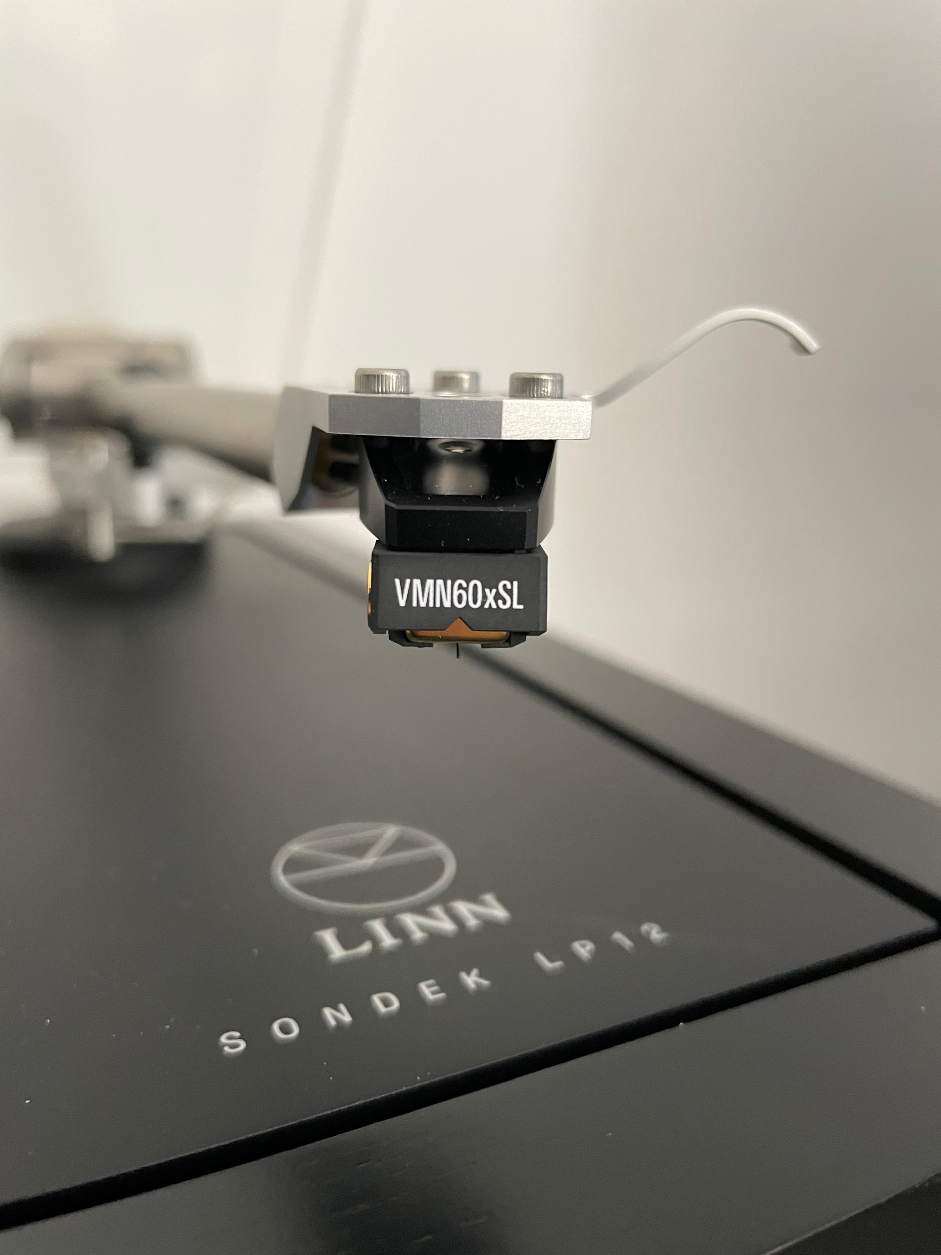

Audio Technica VM95 with a RigB body mod.

I got my TrigB body mod for my cartridge done by them through Cymbiosis.
Well worth doing. :+1:
T in front of RigB means Linn 3 point mount.

An Audio Technica VM95 stylus will fit a K9 body but not the K18. However, IIRC just a small modification is needed to make one fit.
However, it might be just as easier to get a new cartridge.
