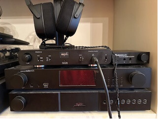

So I tracked down a SPL Phonitor SE, made for the home audio market with cross feed. For most modern recordings it makes no difference. But for the Black Saint, it was pretty remarkable as the effect brought the above mentioned piano to life, upping the sound quality more than I expected.
For those who use headphones a lot, a headphone amplifier with cross feed is worth investigating. I was lucky to find a shop demo unit at half price.
