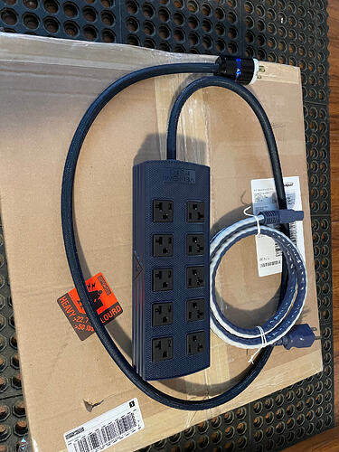

Why not get a power distributor with no conditioning or surge protection? Like the Shunyata Venom that I use, comes with power cord built in.
Edit, must of been another thread you had the photo of a surge protector.
Yes, I was using an APC surge protector when I first installed the Naim amps. I switched to an audiophile power conditioner several days later when someone suggested the APC is no good.
I’m currently investigating on the options but am in no hurry. Plixir Elite BAC, Puritan PSM, and now Shunyata Venom.
