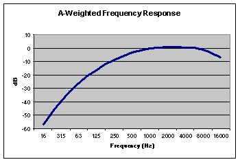

A Weighting
*The most common weighting that is used in noise measurement is A-Weighting. Like the human ear, this effectively cuts off the lower and higher frequencies that the average person cannot hear. Defined in the sound level meter standards (IEC 60651, IEC 60804, IEC 61672, ANSI S1.4), a graph of the frequency response can be seen to the right.

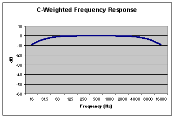

C Weighting
The response of the human ear varies with the sound level. At higher levels, 100 dB and above, the ear’s response is flatter, as shown in the C-Weighted Response to the right. Although the A-Weighted response is used for most applications, C-Weighting is also available on many sound level meters. C Weighting is usually used for Peak measurements and also in some entertainment noise measurement, where the transmission of bass noise can be a problem.
