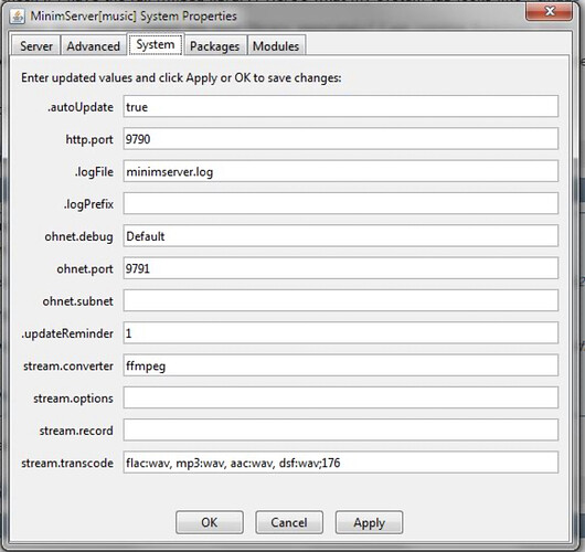

Enter wav:flac in the stream.transcode box, see below. Note that in this case, transcoding from other formats has been set too, but you can ignore this. Full instructions here: User guide

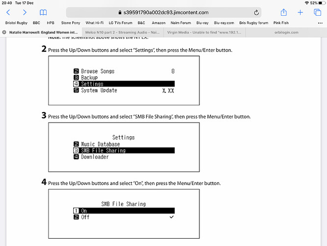

Mine is too… can you see the Melco shared folder via your pc in windows? Is smb sharing enabled on Melco?
Smb sharing enabled didn’t put attention where do I see it?
yours position is pointed as off I understand that I have to change it to on… right?
Yes this is just a picture from the manual

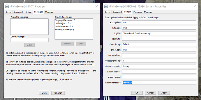

@Meni to see Minim via ypur pc you need minimwatch 2 you may need to disable your virus checker to set it running but once working you can put it back on (Norton 360 for instance will block it). then you can set it up as per @ChrisSU exaple above but go to the packages tab first and add all the avalable packages as below, note leave off 24 if you only want normal wav.
