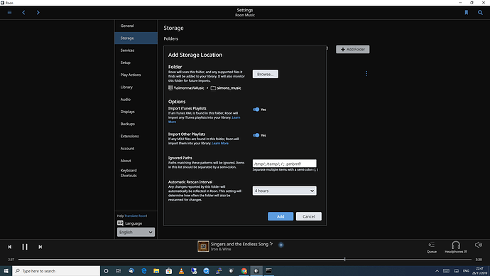

Yes, I understand. But 3 out of the 4 have now turned up. The second one ripped has not yet turned up, but will probably be there by morning. What particular setting do you think I should change?
In storage you can set how often library is scanned. Up this. Its likely at default of 4 hours. It does sound like the Melco like most nas devices being Linux based are not sending file updates across the network so Roon is not detecting changes until its performing its own rescan. If music is on the same system as the roon server this does not happen as the os communicates file changes immediately. Its a disadvantage of having music remote from the core. Not a big thing if you change the frequency of the rescan.

I pretty much always have to force a re-scan. I don’t add music all that often, so it’s not much of an issue for me.
How do you force a rescan?
Settings > Storage Click the little three dots and select “Force Rescan”
Thanks, but it didn’t show up the missing CD. I’ll bet it’s there by the morning though. It always is.
