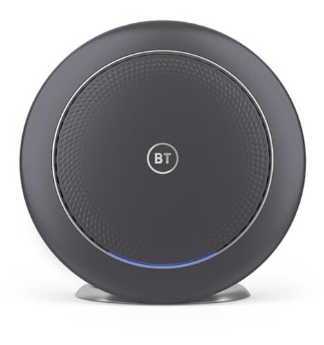

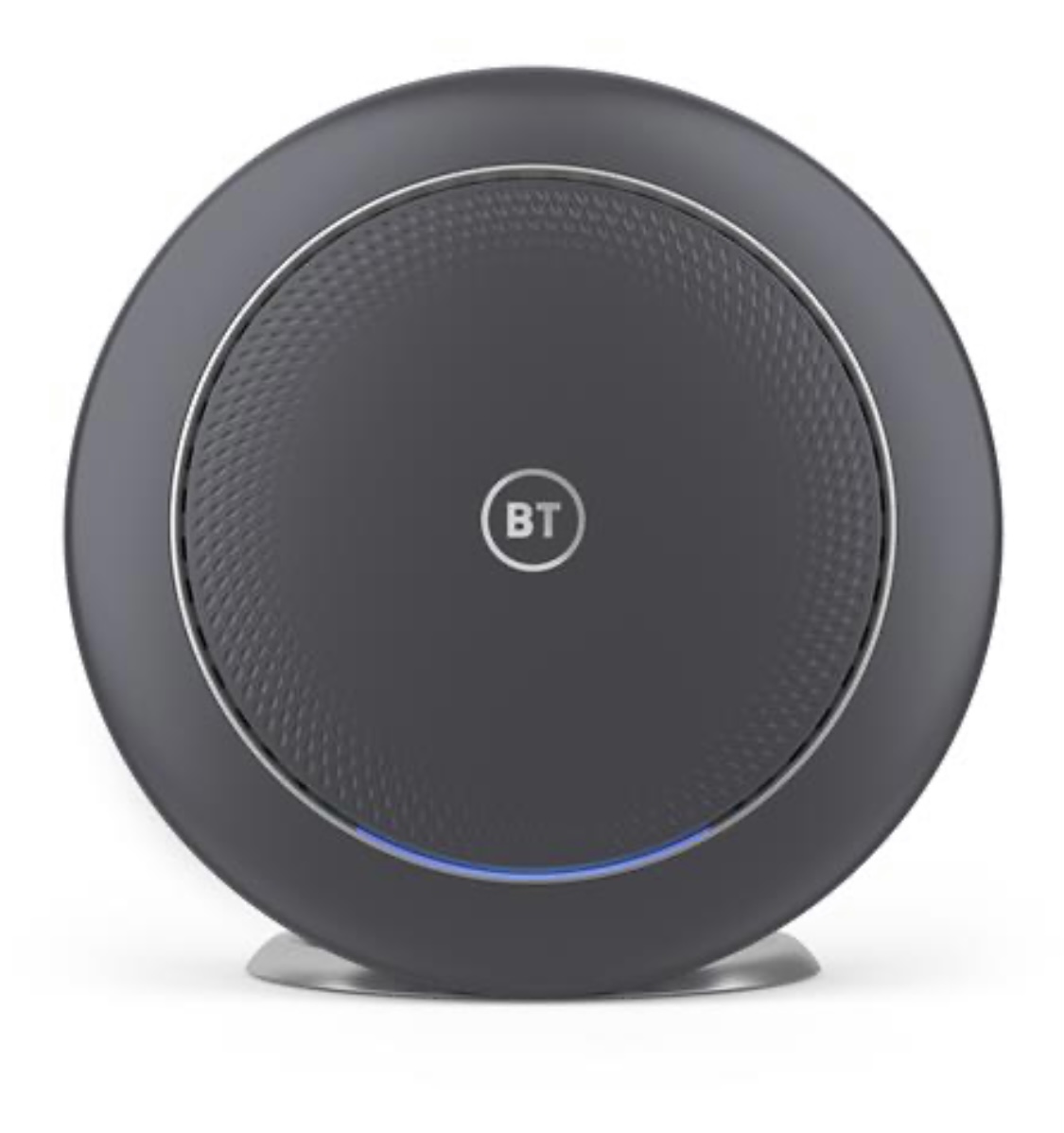

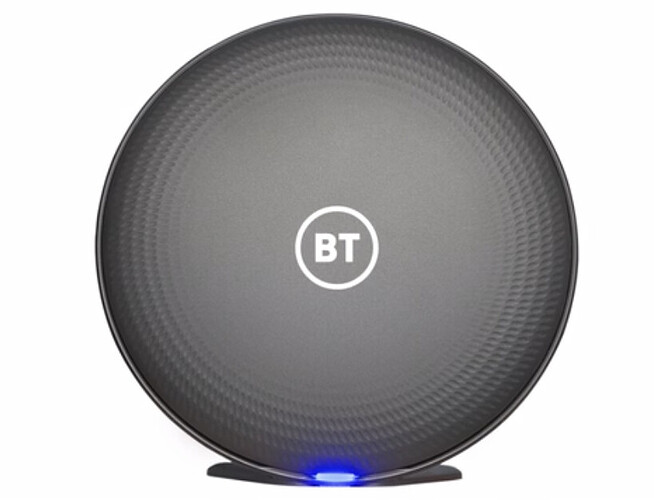

On the BT website they will be calling the Black discs WiFi6. I’m pretty sure they have changed the appearance too.
New:
Old:
