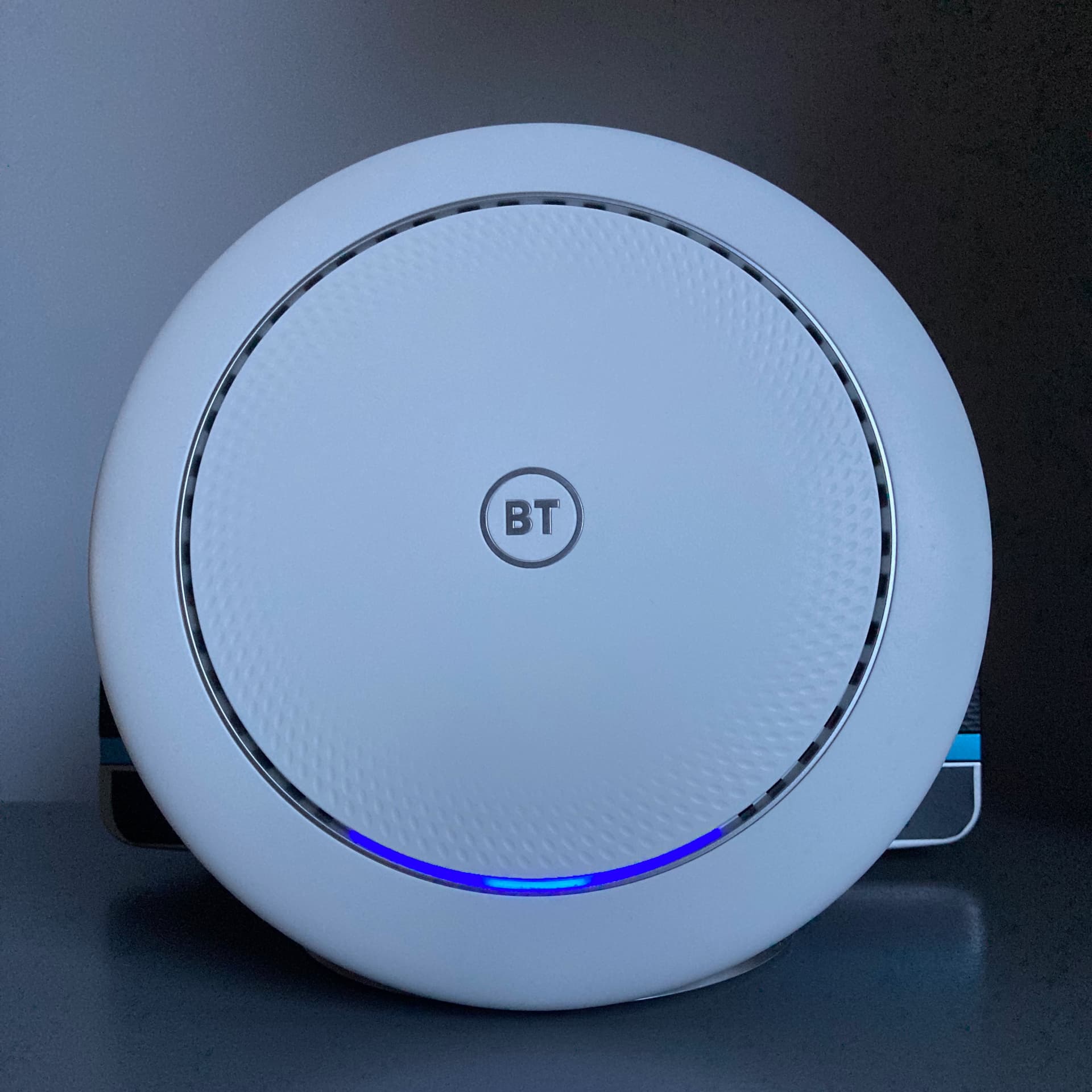

A pack of Whole Home Premium x 3 discs received first thing and installed this afternoon. So far so good, a nice improvement gained. We now have seamless Wi-fi roving throughout the house, and even a strong reception upstairs too. The annex where my work room is was the main concern, and so far, no issues pairing or drop outs to the main disc near the router (connected via ethernet cable to a Cisco switch), and all works just fine with the UQ2.
As an aside, I was quite surprised how big the discs are are, they are mahoosive! I expected them to be about 10cm across, not just under 20cm in diameter.

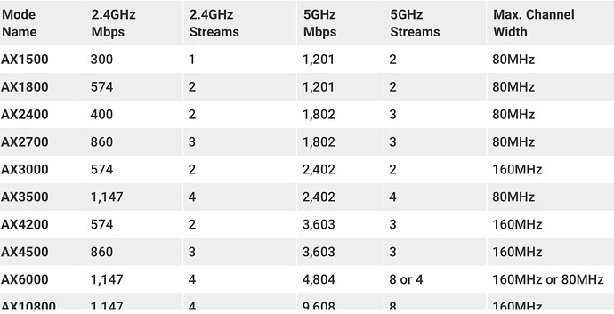

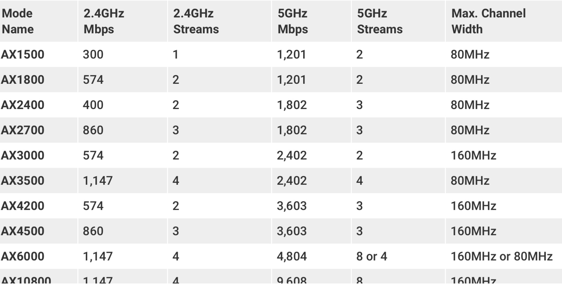

Can anyone please confirm what the real world advantages would be of the BT Whole Home Wi-Fi 6 Tri-band AX6600 over these AX3700 discs?
This may be of use, it’s primarily about total throughput and concurrency of client connections, either will be fine in most domestic environments.
The numbers are derived from the total theoretical bandwidth the radios can support combined and as a total.
Channel width and total
number of antennas for transmit and receive define the interface bandwidth/throughput capability.

@Mr.M Apologies, I’d forgotten to check on the thread. Many thanks for posting that comparison chart, very helpful indeed. The spec numbers show a clear improvement in performance, but wonder how that would be for real world usage. Still keeping an eye on the prices of the latests black discs though.

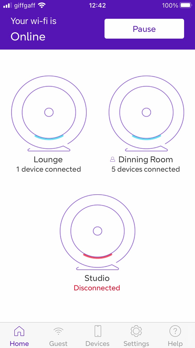

Oh heck - sorry to read that you are having such connectivity issues, and hope you manage to resolve the situation with BT’s guidance and update your discs. I’ve also had some teething problems with the App not recognising discs, and the odd disc throwing a wobbler every now and glowing with the orange light of doom.

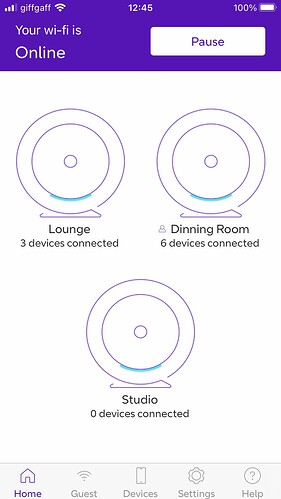

We’ve also had serious BT Broadband outages for a whole week (due to roadworks, thankfully now resolved). So once the BT service was stable I decided reboot the router, then do a factory reset on all discs, deleting and reinstalled the BT App, literally starting from scratch with the whole shebang. Thankfully it has been fairly stable since. Although, it has started to make me think about looking at an alternative Wi-Fi mesh system outside of BT. For ref, all three discs are hard wired (via two Cisco switches) to the BT Smart Hub2.
The orange glow from the App this morning for my Studio, but all was working just fine and devices were connected. Rebooted the disc and all reading correctly again - sigh. Wi-Fi fun and games.
